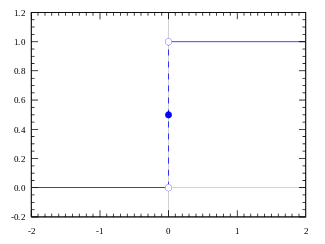

if the mass is spread out in a perfectly 2d layer of zero width
then the gravity goes from g at the surface to zero in the interior an infinitesimal distance away.
So you take one half.
(just imagine that the width is arbitrarily small but non-zero and imagine how the field changes over the width)
Theres a theorem somewhere about that but I can't think of the name of it.
http://en.wikipedia.org/wiki/Heaviside_step_function#Zero_argument
The Heaviside step function, using the half-maximum convention​

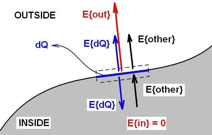

I guess you can find this argument in most classical electrodynamics textbook, but let me introduce it to you (again). No need for an insane integral.
See the attached picture. Here I consider a charge element dQ. Assume that the conductor is in electrostatic equilibrium, then the total E-field outside is [tex]E_{out}=\sigma / \epsilon_0[/tex] and the one inside is 0.
Now thanks to the principle of superposition, we can split the total E-field into 2 parts: one due to dQ only [tex]E_{dQ}[/tex], the other due to the rest (dQ excluded) [tex]E_{other}[/tex].
For [tex]E_{dQ}[/tex], it's just like E-field due to an infinite uniformly charged plane. That is because of this assumption: we consider that the width of the charge layer is PHYSICALLY 0, i.e. even if how small dS is, dS is still a lot larger than that width. This assumption is the basic assumption in many continuous charge distribution model; otherwise, we would have to zoom it at the microscopic scale, and deal with a chain of separate electrons and atoms, which is crazy and unnecessarily complicated. Therefore, [tex]E_{dQ}=\sigma / 2\epsilon_0[/tex]. Notice that [tex]E_{dQ}[/tex] has different directions on different side of dQ.
For [tex]E_{other}[/tex], we don't have to calculate it now. But one thing we can be sure about is that it is CONTINUOUS at the position of dQ. This is due to an important characteristics of E-field: the E-field due to a distribution of charge is only discontinuous when passing through charges. Here the distribution of charge excludes dQ, and we only consider the E-field due to this distribution (i.e. ignore the existence of dQ), so passing through the position of dQ, there is no charges and thus [tex]E_{other}[/tex] is continuous, which corresponds to the unchanged direction of [tex]E_{other}[/tex] at the position of dQ.
So from the conclusions about the directions, we have:
OUTSIDE: [tex]E_{out} = E_{dQ} + E_{other}[/tex], so: [tex]E_{other} = E_{out} - E_{dQ} = \sigma / 2\epsilon_0[/tex]
INSIDE: [tex]E_{in} = E_{dQ} - E_{other}[/tex], and we can see that the above result [tex]E_{other} = \sigma / 2\epsilon_0[/tex] is consistent with the fact that [tex]E_{in} = 0[/tex].
We know that the force on dQ is due to E-field of the rest: [tex]dF = E_{other}dQ[/tex]. So now do you need a crazy integral? :wink:

Applying this argument to my proof above, we don't even need to find [tex]E_{dQ}[/tex]. We only need to know that due to symmetry of the E-field, [tex]E_{dQ}[/tex] has the same magnitude on both sides, and of course, opposite directions (this is also due to symmetry!). Therefore:
[tex]E_{out} = E_{other} + E_{dQ}[/tex]
[tex]E_{in} = E_{other} - E_{dQ}[/tex]
Summing the 2 equations side by side, we obtain:
[tex]E_{other} = \frac{E_{out}+E_{in}}{2}[/tex]
From here, we can deduce the expected result of [tex]E_{other}[/tex].@Quinzio: No comment. I don't like dealing with crazily crazy integral. Good luck :biggrin:
