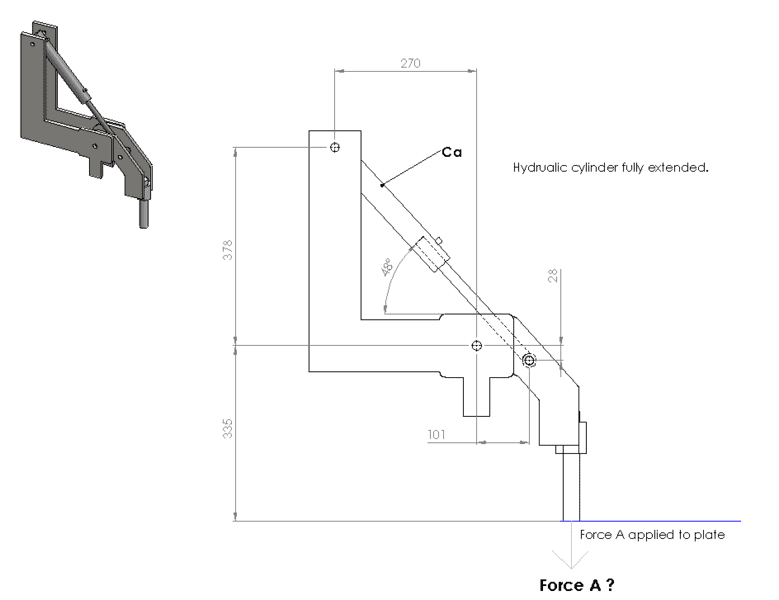

I hope someone out there can help me. I'm designing an add-on to an existing piece of equipment and I'm unsure of how to calculate the resultant force output from a hydraulic cylinder.
On a straight push, the chosen hydraulic cylinder has an extension force of 16.8KN.
BUT, what will be the output force (A) in the configuration sketched below (Dimensions in mm). I know for an angled push I can calculate the X or Y component of the force by multiplying by Sin or Cos of the angle accordingly but I don't think its that simple in this instance.
Its been many years since I've done this sort of thing so I'm getting nowhere, any and all help welcome.
Cheers,
Ian

The sum of the torques about the axis of rotation = 0. There are several (slightly different) tactical approaches. I would express both forces (cylinder, A) in radial and tangent components (so I could ignore the radial). You're missing some dimensions (location where force A is applied), no matter what method you choose.

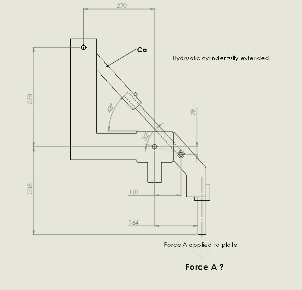

Thank-you for your reply.

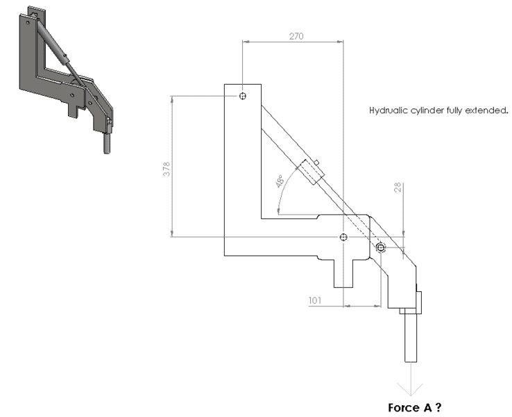

There is only 1 cylinder Ca. Force A is applied by the cylinder rotating the arm down. An adjustable length screw contacts a flat surface.
Missing Dimension added below. This dimension will change depending on the thickness of the plate the force is being applied to (range of about 30mm)
Likes CWatters
Understood. You still need a dim for the 'x' location of force 'A' (you added only the 'Y' location).

Can you say a bit more about what this mechanism is doing? The hydraulic cylinder would seem to have very poor leverage if your intention is to rotate the arm about its pivot point...
The resulting force will vary depending upon the cylinder angle at the point of contact of your pressing pin on your material.
For the 48° position shown, the vertical component of force the cylinder applies to the lower arm equals the cylinder force x sin 48°; the resulting torque on the arm then equals that vertical force x 101 (the horizontal distance from the arm pivot pin c/c to the cylinder connecting pin c/l); the resulting vertical force applied to the vertical pressing pin then equals that torque divided by the horizontal distance from the arm pivot c/l to the vertical pressing pin c/l (which is missing from your figure).

Missing dimension added below.

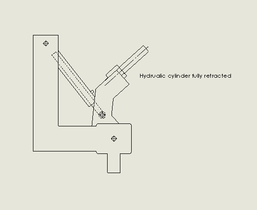

My intention is to have a series of these arms to hold a pipe in position as an automatic welding machine goes past. Each arm would move out of the way in turn to allow welding. At the moment I have a manual machine, each arm is held in position by a locking pin and the extending screw is tightened onto the pipe to prevent movement during welding. The idea is to automate this process. For info, the pipe is also supported separately, the moveable legs only aid line-up at the faces to be welded.
I need the pivot point in such a place so that the arm is completely out of the way when retracted. See second picture.

Thanks for the reply, would you then agree with the following calculation?
Sin48 x 16.8e3 = 12.48e3 N
12.48e3x101e-3 = 1260.9 N/m
If the horizontal distance between the arm pivot and the press pin is 180mm then:
1260.9/180e-3 = 7005N (715Kg)
That appears to be correct.
One observation regarding the retracted position alignment of the cylinder rod pin with the direct line between the cylinder mounting pin and the pivot pin. In that position, there is an almost negligible of the cylinder force that is directed toward starting the rotation of the arm and a large amount of direct force from the cylinder directly on the pivot pin which could result in wearing of the pin joint. Additionally, this can result in a very rapid acceleration of the pivot arm through its closing stroke unless the hydraulic feed rate to the cylinder is controlled.
I would recommend that you consider moving the cylinder rod pin a bit further to the right to increase a bit its offset from the direct line between the cylinder mounting pin and the pivot pin; and, carefully control your cylinder inlet flow rate to prevent an almost snap action closing of your clamp.

I think that the force is more like 5250 N (535 Kg). The horizontal component of the cylinder has to be accounted for, as it is not directed into the point of rotation.

I stand by my answer. I don't believe that your technique respects the constraint imposed by the pivot pin.
I prefer a slightly different way to do these type of calculations.
1) Draw a centerline down the center of the cylinder.
2) Measure the perpendicular distance from that centerline to the center of the pivot. Most, if not all, CAD programs have ways to make this measurement. Or you can measure it with a ruler.
3) Cylinder force times perpendicular distance equals moment applied to the arm.
4) Divide by the horizontal distance from the pivot to the center of the point of contact (164 mm plus half diameter of pin) to get force on the plate. Or, stated more correctly, sum of moments equals zero. The force against the plate is assumed to be vertical.
5) Pay close attention to what @JBA said in post #10. Add some friction to the pivot pin, and the whole mechanism could bind up when retracted.
6) Now that you have the forces, the force on the pivot pin is the vector sum of those forces.

Using this method I get a similar answer to that explained by JBA and Dullard.
16.8e3 x 55e-3 (Point 2) = 924 N-m
924/180e-3 = 5133.3N (523kg)
