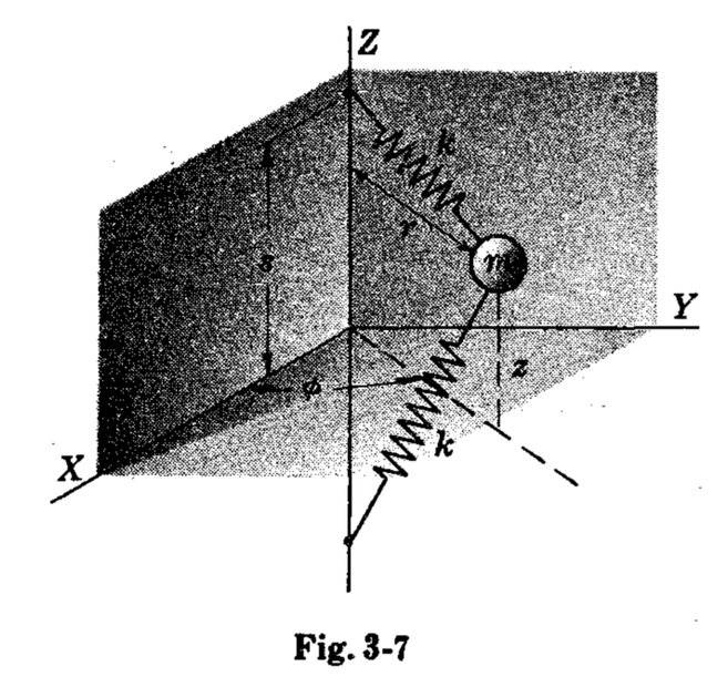

The particle of mass m, shown in Fig. 3-7 below, is free to move to any position under the action of the two identical springs. When m is in equilibrium at the origin of the coordinate axes, the length S of either spring is greater than the unstretched length l_0.
Show that ##F_\phi = 0##.
Show that, for very small displacements from equilibrium, $$F_x = -2k(1 - \frac{l_0}{S})x, F_y = -2k(1 - \frac{l_0}{S})y, F_z = -2kz$$
## F = -\frac{\partial V}{\partial q} ##, ## V_{spring} = \frac{1}{2} kx^2 ##
So at first I tried to express the potential energy as a function of x, y and z, but since I'm not quite sure about the geometry of the situation, I decided to separate out the potential energy into three components: ##V_x, V_y, V_z## (I'm pretty sure this is valid because in the partial derivative with respect to one coordinate all the parts of the potential energy not related to that coordinate will go to 0 as constants.)
I used the formula for the potential energy of a spring to get ## V_x = 2 * \frac{1}{2} kx^2 ## (2 out front because there's two springs.) But even after taking the derivative of that I didn't get anything in terms of the fraction of ## l_0 ## and ## S ##? What would that fraction even represent geometrically? I got ## F_x = -2kx ##, which interestingly enough would be the correct expression if I did this with the z coordinates, but the thing is with the z coordinates is that there's also the potential energy due to gravity to consider - mgz, so ## V_z = 2 * \frac{1}{2} kz^2 + mgz ##, but then the force becomes ## F_z = -2kz - mg ##?
And maybe setting up the equations of motion and then multiplying the expressions for ##\ddot{x}, \ddot{y}, \ddot{z}## by the mass (F = ma) would be easier, but I struggle to see how that'd be more correct? Plus, I'm not even sure how to derive an expression for the kinetic energy in this scenario.
As for showing that ##F_\phi = 0##, I know I need to derive an expression for the potential energy in terms of ##\phi##, but I'm not sure how to do that at all.
I assume is this just F as a magnitude. Seems obvious since no springs change length there.

Changing theta, according to the diagram, is just a rotation of the system about the z axis. Neither spring changes length.

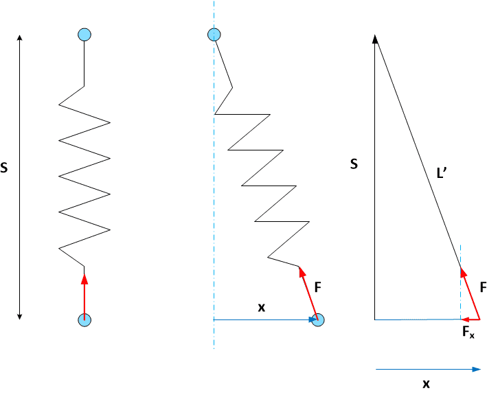

I don't follow. You want ##F_x## , not V.
In the left pic you see ##m## at the origin. In the center picture you see ##m## at position x. Force ##F## is found with ## F = k(L'- l_0)## where ##L'## follows from Pythagoras. And the ##x##-component is then minus ##F## times a cosine which is also easily seen in the picture at right.
Lower half omitted for clarity -- a 2 can be factored in once you have ##F_x## from one spring.

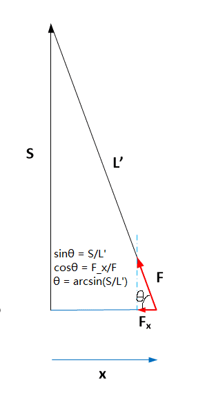

Okay, yeah, that makes sense, so the ##F_x = Fcosθ = 2k(\sqrt(x^2+y^2+(z - S)^2) - l_0)cos(arcsin(\frac{S}{\sqrt(x^2+y^2+(z - S)^2)}))## but that... that seems like too much trigonometry to be correct, plus I don't think there's a trig identity that simplifies cos(arcsin(whatever))? Could be wrong though, trigonometry isn't my strong suite.
giraffe714 said:
Okay, yeah, that makes sense, so the ##F_x = F\cos\theta = 2k(\sqrt{x^2+y^2+(z - S)^2} - l_0)\cos(\arcsin(\frac{S}{\sqrt{x^2+y^2+(z - S)^2}}))## but that... that seems like too much trigonometry to be correct, plus I don't think there's a trig identity that simplifies cos(arcsin(whatever))? Could be wrong though, trigonometry isn't my strong suite.
##\cos\theta ## is also equal to ##x/L'## ! And you want to stop using ##\sqrt{x^2+y^2+(z - S)^2}##. Just vary x and leave the others 0.
giraffe714 said:
Okay, yeah, that makes sense, so the ##F_x = Fcosθ = 2k(\sqrt(x^2+y^2+(z - S)^2) - l_0)cos(arcsin(\frac{S}{\sqrt(x^2+y^2+(z - S)^2)}))## but that... that seems like too much trigonometry to be correct, plus I don't think there's a trig identity that simplifies cos(arcsin(whatever))? Could be wrong though, trigonometry isn't my strong suit.
If you have the arcsin as some function ( reading the arc whose sine is …), you can express the cosine using those same variables using Pythagorean Theorem.
If ##\theta=\arcsin(x)## then ##x=\sin(\theta)## and ##\cos(\arcsin(x))=\cos(\theta)=\sqrt{1-\sin^2(\theta)}=\sqrt{1-x^2}##.
