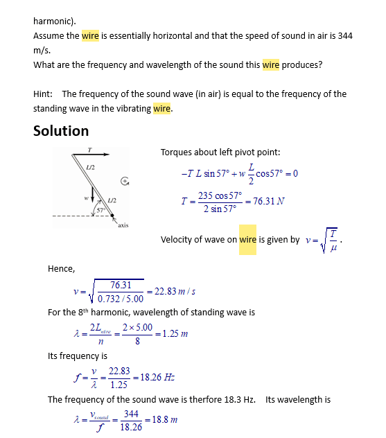

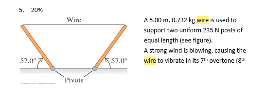

A 6.00 m, 0.732 kg wire is used to support two uniform 235 N posts of equal length (the figure (Figure 1)). Assume that the wire is essentially horizontal and that the speed of sound is 344 m/s. A strong wind is blowing, causing the wire to vibrate in its 5th overtone.
\sum tau = 0
Hello,
Can someone help me out with this one. I solved the exercise but didn't get the right answer so I went searching on internet for solutions. It seems something was wrong with my force-diagram. In my force diagram I had another force included excerted by the wire on the post, since the wire has weight that must be carried by the posts there has to be a reaction force hasn't it? Although in the solutions I added to the post the only force excerted by the wire on the post is horizontal tension force that cannot cancel out the weight of the wire.
Thank you in advance!
Since you are assuming the wire to be horizontal, you can ignore the weight of the wire (at least as far as the tension goes). (Compare the weight of the wire to that of the posts.)
Hi Doc Al
The weight of the wire of 7N seems (although much less) not insignificant however. I understand that since the posts are pulling the wire horizontally they cannot carry the weight of the wire, but at the mean time they are the only possibility to carry it. Is there still a mistake in my thinking?
Likes Delta2
Hi Doc Al
Your thinking makes perfect sense. In "real life" the wire cannot be perfectly horizontal if it has weight and the posts must support the weight of the wire. But, for the purpose of this textbook problem, you can make the simplifying assumption that the wire is horizontal and its weight can be neglected in your force diagram.
Likes Engineering_stud
Thank you, I get it. It was a bit confusing since it was the first time I encountered such a 'perfectly horizontal' wire.
Hi Doc Al
You could add half of the weight of the wire to the weight of each post, and then calculate the moment each of those vertical forces create about the ground pivot.
Those two combined moments will induce a tension on the wire, which is the information needed to calculate the characteristics of the wind-driven vibration.
As it is represented, the mechanism is non-stable, unless the rotation of each pivot is limited in such way that the angle between each pole and ground is not much less than 57°.
Likes haruspex
Yes, that'd be close. The small inaccuracy is that the sag in the wire reduces the torque arm of the tension, increasing the tension needed to balance the weights.
Likes Lnewqban
If one worries about a (slightly) sagging wire, wouldn't one also have to consider that the poles oscillate as the wire vibrates? At least one would have to show that resonances may be ignored.
Likes Lnewqban
I was worried that the weight of the wire might disproportionately increase the tension, but I no longer think so.
The biggest flaw in the problem from a practical perspective was pointed out by @Lnewqban in post #7: the whole system is unstable and would collapse to one side. That makes an analysis of the oscillations of the poles somewhat irrelevant.
