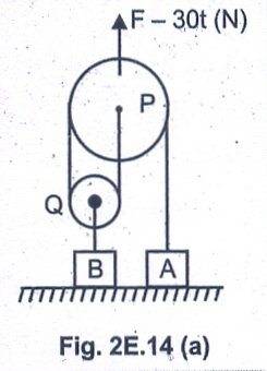

Two blocks ##A## and ##B## having masses ##m_1= 1 kg, m_2 = 4 kg## are arranged as shown in the figure, The pulleys ##P## and ##Q## are light and frictionless. All the blocks are resting on a horizontal floor and the pulleys are held such that strings remain just taut.
At moment ##t=0## a force ##F = 30 t (N)## starts acting on the pulley P along vertically upward direction as shown in the figure. Calculate,
(i) the time when the blocks A and B loose contact with ground.
(ii) the velocity of A when B looses contact with ground
(iii) the height raised by A upto this instant.
(iv) the, work done by the force F upto this instant.

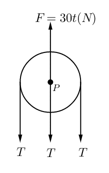

(i)
FBD of pulley ##P##
From the above image it is clear that $$T=10t$$

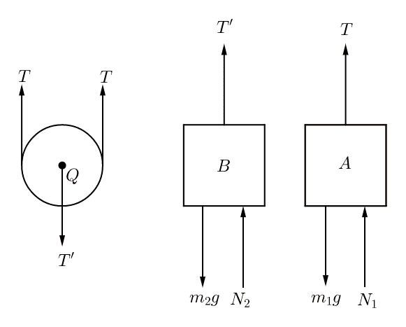

FBDs of block ##A##, ##B## and the pulley ##Q##
From the FBD of pulley ##Q##, we get
$$T'=2T=20t$$
From the FBD of block ##A##, we get
$$N_1+T=m_1g$$
As the block ##A## is about to loose contact with the ground the normal reaction form the ground vanishes, i.e. ##N_1=0##
So, $$T=m_1g\implies 10t=1\times 10\implies t=1\text{ sec}$$
From the FBD of block ##B##, we get
$$T'+N_2=m_2g\implies 2T+N_2=m_2g$$
Same as for block ##A##, block ##B##, when about to lose contact with ground ##N_2=0##
$$\therefore 2T=m_2g\implies 20t=4\times 10\implies t=2\text{ sec}$$

When ##B## loses contact with the ground, ##A## would have traveled with the acceleration ##a=10t## for ##t=1\text{ sec}##, i.e. from ##t=1 sec## to ##t=2 sec## so the velocity of the block ##A## as ##B## loses contact is found as follows:-
$$V=\int_{0}^{1}{10(t)}dt=5\text{ m/s}$$
(iii)When ##B## loses contact with the ground, ##A## would have traveled with the velocity ##a=10t## for ##t=1\text{ sec}##, i.e. from ##t=1 sec## to ##t=2 sec## so the displacement of the block ##A## from its initial position as ##B## loses contact is found as follows:-
$$X=\int{dx}=\int_{0}^{1}{vdt}=\int_{0}^{1}{(5t^2)dt}=\left(\dfrac{5}{3}t^3\right)^{1}_{0}=\dfrac{5}{3}m$$
(iv) Finally, the question where I am having trouble.
As the force acting on the system is ##F=30t##, but the force that pulls the block ##A## through a distance is the tension, so the work done should be $$\int_{0}^{1}{T.dx}=\int_{0}^{1}{(10t).(5t^2)dt}=\int_{0}^{1}{50t^3dt}=\dfrac{25}{2}J$$.
In my calculation of the work done by the force ##F##, I found it odd that I was using ##T## instead of ##F##, but according to what I know is that that the work done by a force acting on a body is given by the dot product of the force with the displacement vector, so, here the only massive body being displaced is the block ##A##, and the force acting on it is the tension, so I considered tension as the force that acts directly on the block. So, why is my answer different from that of the book's.
You are being asked to calculate work done by 'F' so just do that . 'F' and 'T' are different forces acting on different objects doing different work . Displacement of massive body as a result of force doing any work is irrelevant .
Do you believe the topmost pulley P on which 'F' acts does not move during the time when block A has been lifted till the time block B leaves the ground ?
That's what I thought at first that before the block loses contact with the ground the topmost pulley had been moving, so whether to consider that in the displacement that had occurred due to the force ##F##.or not, or just the displacement of the block ##A## was to be considered. After, this what I thought would seem to be very weird but do clear it for me, so what I thought was that as the force does work on the system the system stores energy. This energy now has to be used so, only massive bodies can have energy, so that's why I ruled out the case where the displacement of the pulley had to be considered. The above line of thought might seem very weird but do clear it for me. Also, if all of this, that I thought, was for naught then does this mean that only the displacement of the topmost pulley has to be considered.
decentfellow said:
Also, if all of this that I thought was for naught then does this mean that only the displacement of the topmost pulley has to be considered.
Yes , only the displacement of the top pulley is taken into account for calculating work done by 'F' .
