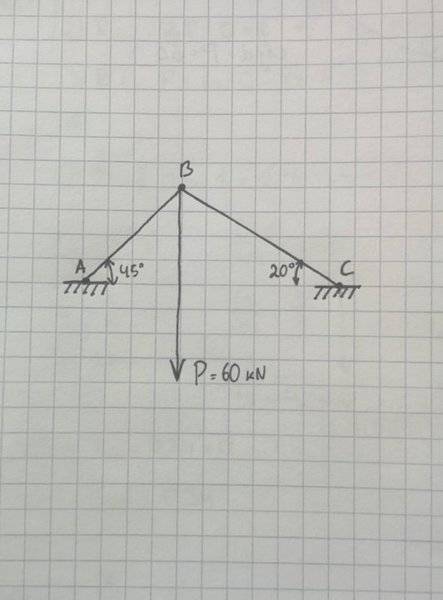

P=60kN
angle alpha = 45 degrees
angle beta = 20 degrees
The task is to calculate the force on the base A and C, and to draw vectors that represent those forces.
I did similar examples at the class, but when I had to do this one on the test, I just could not get it done.
If I could get the balanced equations down correctly, I would manage to do the rest. (balanced force equations on x and y axis)
Sorry if there are wrong terms used, I am not a native speaker. Ill try to explain if there is anything unclear.
Thanks!

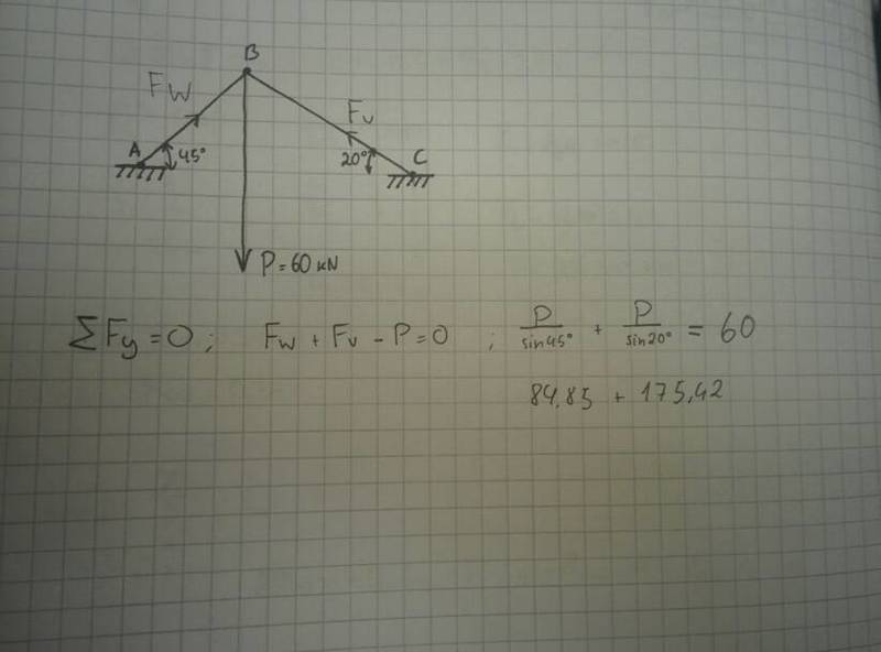

In the picture F and G is Fw and Fv. Is that right? In that case components are. P/sin45 and P/sin20 for the y axis. And P*cos45 and P*cos20 for the x axis. Atleast if I got it right.
You didn't get it right.
Step 1 - Forget about P.
Step 2 - From the trigonometry, what are the components of F and G in terms of F, G, and the angles.

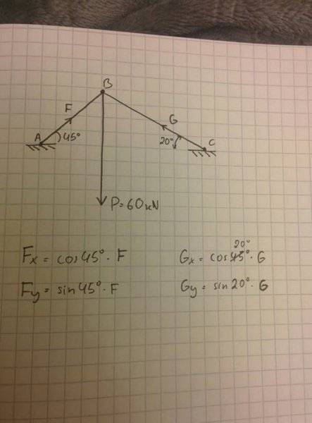

Like this?
Yes. Very nice.
The signs on the G components should be - in the x direction and + in the y direction. Now, using the upper junction point as your free body, do a force balance in the x direction and a force balance in the y direction on the junction point. What do you get?

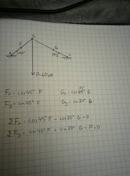

I hope I understood correctly what you asked due to the language barier.
But I guess this is what you meant:
Excellent. Now solve for F and G.

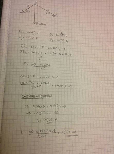

Is this correct?
Your methodology is correct. I didn't check your algebra. If you want to do that, just substitute your results into the two force balance equations and see if the equations are satisfied.
Great! Thanks! To both of you.

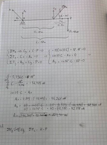

Im sorry. Could you please tell me where I am wrong again? I am using the same methodology, but I have a feeling its incorrect, cause I can't find the second force momentum equation.
The A, Ax, Ay, C , Cy and Cx is added by me. Everything else was given.
Why am I getting a negative Cy, when it should be positive?
I do not understand the connection between this post and the rest of this thread. What are Ax etc.?

Oh sorry.. the image was not uploaded.
Here:
Here:
Please start a new thread for this new problem.
