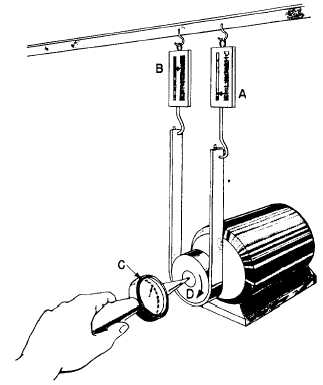

The more I think about this, the more I believe we may be taking the wrong approach. Our entire force profile over the stroke length of the lever is dependent on resistance. We want this lever to return home when it is released, but have a specific "feel" when pushing/pulling it. A spring on a crank would mimic the profile quite well, but it isn't variable/programmable.
I'm starting to think more in terms of braking systems than drive systems. The YouTube video below is a linear actuator that I may be able to make work, but I don't know if it would have enough power for our purposes.
If there are any suggestions of hardware that can act as an arduino based resistance mechanism I would be very appreciative to hear it. My search results have come up null so far.

Anything that can be electrically controlled. Although probably not the best choice, the first thing that comes to mind is a Prony Brake, http://enginemechanics.tpub.com/14037/css/Figure-8-3-A-Prony-Brake-53.htm, replace a scale with something (motor, solenoid...?) that adjusts the tension in the strap. You will have to add a Transistor stage or two to the Arduino output to handle the higher current that the actuator needs.
Likes MacLaddy
Tom.G said:
Afraid not. My background is Electronics and my back-driving comment was based on occasional observation over the years. I surmise you would have to find the static friction of each item from the motor to the output shaft and adjust for the gear ratio from each item to output. Then decide if the output device and each reduction stage can handle that torque.Connect the fixed end of the spring to something (an arm or crank?) that is controlled by a motor; or to a string (fishing line?) that wraps around a motorized drum.Anything that can be electrically controlled. Although probably not the best choice, the first thing that comes to mind is a Prony Brake, http://enginemechanics.tpub.com/14037/css/Figure-8-3-A-Prony-Brake-53.htm, replace a scale with something (motor, solenoid...?) that adjusts the tension in the strap. You will have to add a Transistor stage or two to the Arduino output to handle the higher current that the actuator needs.
That's an interesting mechanism, thank you. I'll start trying to wrap my head around these options and see what comes out of it.
