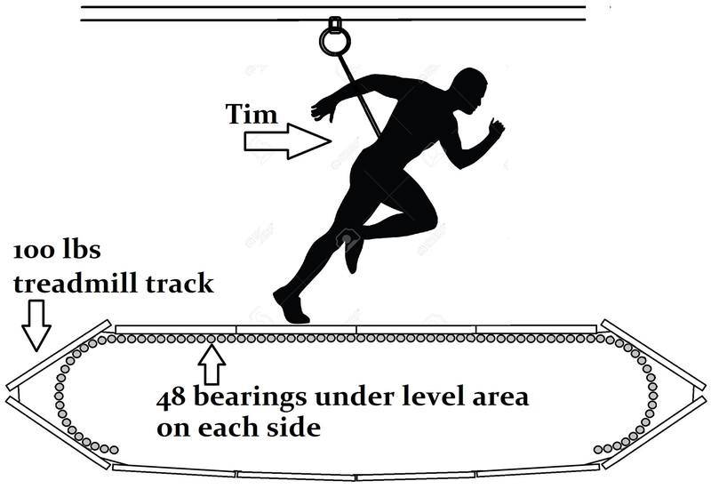

I apologize if this is in the wrong thread, I'm new.
I need to figure out how hard it would be for Jim to move the treadmill treads along its track of bearings. This isn't for homework, it's just something I want to know.
Jim weighs 160 lbs.
The rope isn't holding him up, it's there for him to lean forward against so he moves the treadmill with his legs instead of moving himself.
The entire treadmill track weighs 100 lbs, not each individual piece.
The reason I know this is a reasonable question to ask is because the weight on each bearing while it needs to turn is much less than the weight on skateboard bearings which normal people move all the time with one leg while standing on the skateboard. The bearings should only need to spin under 10 lbs of weight (assuming the weight of the entire thing was on one section, which is a vast over exaggeration) when normal skateboard bearings spin under /40 lbs each/.
A skateboard has four wheels and people on skateboards can push themselves along with one leg while standing on the skateboard. Their body weight divided by the number of wheels (160 divided by 4 = 40 pounds per wheel) and since we know moving a skateboard works in this manner with that kind of weight on each of the bearings. So for the treadmill if we divide 260 (weight of treadmill track plus weight of person) by 24 (the number of bearings supporting just /one/ of the treadmill tracks, assuming the worst that the weight of everything is on just one area) we get 10 pounds of weight per bearing, which is still 30 pounds less than the weight on the bearings of a normal skateboard so this seems to show to me that it can't be /that/ hard to move this kind of treadmill manually.
The bearings are the same type used in regular skateboards type-608 bearings.
Let me know if you need more information than is printed in the picture.

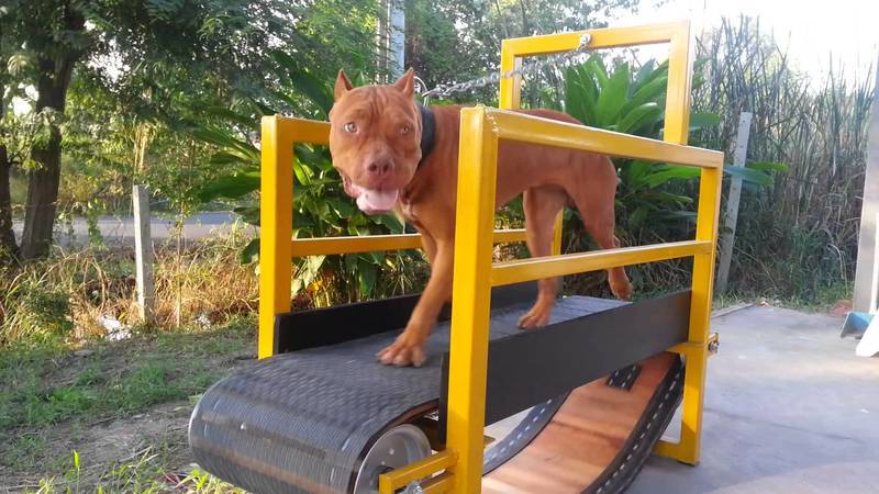

These kinds of manual treadmills do exist for dogs, they're called slatmills and either dog nor human slip quite /that/ dramatically so I think you're overestimating the lack of friction a bit too much. The reason I need to knwo how hard it would be to push the slats along is because my version is about 100 pounds for the weight of all the slats, considerably more than normal tiny little slatmills.
And hamsters have wheels, too. In both those cases, the animals have four legs and would not fall on their faces. :smile: A hamster on a wheel is alarming to watch. The wheel is a similar mass to a hamster and their movement on the wheel is very unstable. They climb up the front and then it comes down and they are carried backwards. There's a pendulum motion and I cannot see a human getting on with that when they want a simulated road.

You are missing the point. The reaction force from the tread, if there is no / low friction will be there, initially, as you start to accelerate it. Once it has reached the fasted speed that your legs can give it, you cannot get any force backwards. This is Newton's First Law and can't be ignored. Your legs will constantly need to be going backwards as fast as they can and you will need to hand onto the support to prevent you from falling on your face. You could achieve that (final) situation by trying to run on a block of ice. If you want to simulate the normal running experience, you need something for your legs to 'bear on', which can either be the ground (normal running, as I have already described) or a powered / braked tread.
Your picture of an unpowered human treadmill doesn't show the mechanism used for the tread so it proves nothing about the basics involved in this.
I detect a reluctance on your part to take seriously what you are being told by Physicists and Engineers. Why did you approach PF for an answer if you ignore what you are being told? Ask yourself why the market is not flooded with treadmills, based on your idea. You can hardly be the only person to have thought of it. The reason is PHYSICS.

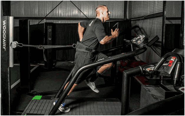

The photograph appears to show a 'Force' model. From the Woodway website (my underline),
The Force is a manual, stationary, sport loading platform designed specifically for speed, acceleration, and athletic performance training. With an electro-magnetic braking system built in, this performance treadmill is designed to increase resistance and push athletes to their limits. Equipped with an adjustable harness and varying levels of resistance, the Force is a dynamic training tool for all athletes looking to improve quickness, power, and anaerobic endurance.
Likes sophiecentaur
The braking is done electromagnetically (dynamo and resistor - as I suggested).

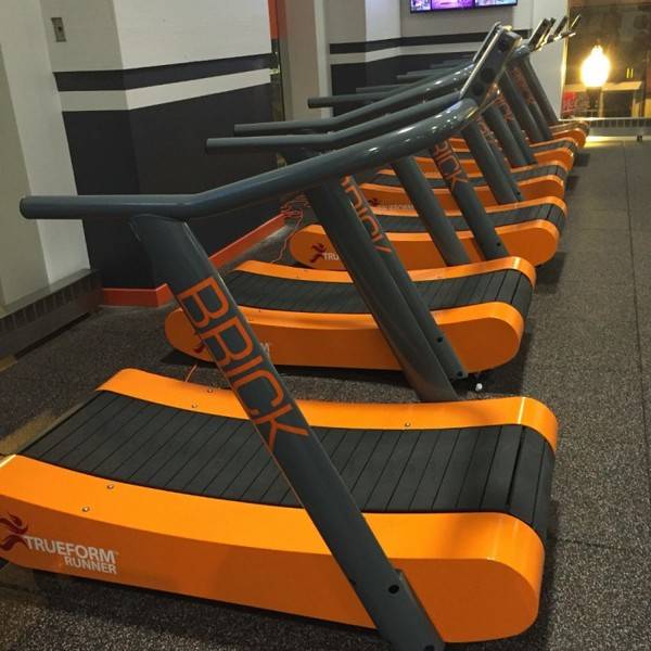

The market /does/ have many treadmills based on my idea (its not my idea just a re-imagining of the concept) - I came here because in my plans to build one by myself based on the ones I saw out in the market I needed to know how much force moving 100lbs along many small bearings would take because I /already know/ the concept works having seen many human powered manual treadmills that are commercially produced without the need for breaks.
For this reason, I think you are misunderstanding Newton's First Law because of the fact that manual treadmills similar to mine exist /without/ the need for a breaking system on the treads. Similar treadmills also exist for dogs as well as humans (I'll post a picture of one designed for dogs and notice it has no breaks needed because the weight of the wood being moved by the animal is enough) The picture of the manual treadmill I posted earlier has a magnetic breaking system to make it more difficult for the athletes because it is designed for speed work not because a break is inherently necessary. You cannot see the wheels because of those black steel rectangles, but they're there just line in my re-imagining of the concept.

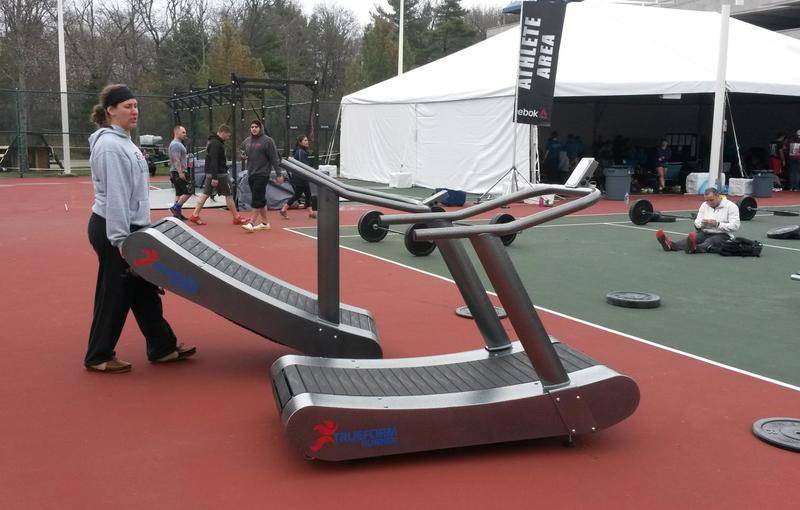

The picture of the manual treadmill I posted earlier has a magnetic breaking system to make it more difficult for the athletes because it is designed for speed work not because a break is inherently necessary as evidenced by these manual treadmills which do not have breaking systems. Which brings me back to my original question if I can convince you the concept actually exists without the need for a break - building one myself, if the wooden boards altogether weigh 100lbs and are on bearings, how much force would it take to move them for someone walking on them and pushing them with their legs being on a treadmill.
The breaking is needed on that particular treadmill because it is designed to be more difficult for athletes not because a breaking system is inherently needed.

No break needed on these manual treadmills:
The force needed to move them at constant speed will be due to internal friction, which is not trivial to estimate.

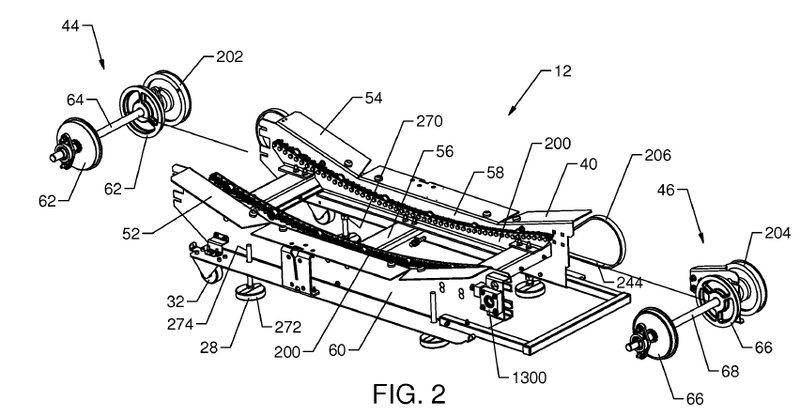

Thought I'd attack this question with a flanking maneuver, and learn what adjustments could be made on a Trueform Runner. One of the hits was a legal document from a count case involving Woodway versus two companies (Chapco, Inc., and Samsara Fitness, Inc.) on the Trueform side. The Woodway patents and design patents cited were 8,986,169, 9,039,580, D736,866, and D763,776.
I only looked at 8,986,169 (and didn't search for any that may be specifically for the Trueform Runner), but Woodway's drawings look very much like the Trueform Runner in previous photos. Quoted from the 'background' section.
Similar to a treadmill powered by a motor, a manual treadmill must also incorporate some system or means to absorb or counteract the forward velocity generated by a user so that the user may generally maintain a substantially static position on the running surface of the treadmill. The counteracting force driving the belt of a manual treadmill is desirably sufficient to move the belt at substantially the same speed as the user so that the user stays in roughly the same static position on the running surface. Unlike motor-driven treadmills, however, this force is not generated by a motor.
It uses a set of bearing rails, too, although only along the upper side of the belt, and from what I've gathered (my eyes went woozy; patents are the very definition of tl;dr) several measures are employed to provide regulatory counterforce, including the "non-planar shape" of the belt contour itself, a one-way bearing assembly, a front drum slightly larger in radius than the rear drum, and a synchronizing belt system between them.
Google Patents
USPO (click on 'Images' then the 'Full Pages' button to get the full patent document including images)

I don't have too much confidence in patents. There is no guarantee that a patented device will even work. It's only done to protect an idea. Amazon reviews could be a good credibility check of a design that's made it to the market.
