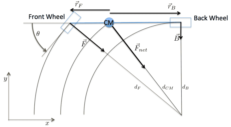

Here is a fully worked-out solution.
Assumptions:
1) The system can be well-approximated as a rod with a wheel on each end.
2) The only forces considered are frictional forces. Air resistance and all other forces are ignored. This assumption could result in significant error if the car is moving at high speed.
3) The system in steady state, turning at a constant speed on a circular arc.
4) The wheels do not slip.
Constant speed and constant turn radius imply that angular momentum is constant and net torque is zero, resulting in
##0 = \vec r_f \times \vec F + \vec r_B \times \vec B##
##0 = |\vec r_F|~F_y + |\vec r_B|~B_y~~~1)##
Constant speed implies that tangential acceleration is zero, so the net force is perpendicular to the velocity vector
##\vec F_{net} = \vec F + \vec B##
##0 = F_x + B_x##
##F_{net} \equiv |\vec F_{net}| = -(F_y + B_y)~~~2)##
Solving 1) and 2) for ##B_y## and ##F_y## gives us
##B_y = -\frac {|r_F|} {|r_F| + |r_B|} F_{net}##
##F_y = -\frac {|r_B|} {|r_F| + |r_B|} F_{net}~~~3)##
which shows that there is a lateral frictional force on the rear wheel.
Since the front wheel rolls at a constant speed without slipping, the frictional force on the wheel must be along its axis. Now here is the tricky part. The net force on the wheel is perpendicular to ##\vec v##, which is not the same direction. How can the tire not slip in that case? The tire deforms to allow it to travel in a different direction than it is rolling.
Given that ##\vec F## is along the wheel axis,
##F_y = -|\vec F| \cos \theta ~~~4)##
Combining 3) and 4), we get
##F \equiv |\vec F| = \frac {|r_B|F_{net}} {(|r_F| + |r_B|)\cos \theta} = \frac {|r_B|m~a_{rad}} {(|r_F| + |r_B|)\cos \theta}##
the magnitude of the frictional force on the front wheel as a function of the radial acceleration ##a_{rad}##.
This has bothered my since I posted it. In thinking about it, I discovered an incorrect assumption in my previous post. The net force is not perpendicular to the body of the car at the center of mass. It is perpendicular at the back wheel. The front and back wheels and the center of mass all revolve around a common center, but at different radii. To justify this new assumption, consider that the back wheel simply moves toward the current position of the front wheel, independent of which direction the front wheel is pointing.
From this we can see that
##d_F = \frac {|r_F| + |r_B|} {\sin \alpha}##
##d_B = \frac {|r_F| + |r_B|} {\tan \alpha}##
##d_{CM} = \sqrt {|r_B|^2 + \left (\frac {|r_F| + |r_B|} {\tan \alpha}\right )^2}##
and
##F_{net} = m \omega^2 \sqrt {|r_B|^2 + \left (\frac {|r_F| + |r_B|} {\tan \alpha}\right )^2}##
where ##\omega## is the angular velocity.
The equations
##0 = \vec r_f \times \vec F + \vec r_B \times \vec B## and
still hold, but now instead of
##0 = F_x + B_x##
we have
##0 = B_x##
solving these equations results in
##F = \frac {|r_B|m~a_{rad}} {(|r_F| + |r_B|)} = \frac {m\omega^2 |r_B|}{\sin \alpha}##
The difference between this and my previous solution is the lack of ##\cos \theta## in the denominator of the expression for ##F##. The front wheels and the back wheels travel in the directions they are rolling, eliminating the need for an uncomfortable explanation of why they don't. This solution also eliminates the need for friction acting in the ##x##-direction on the back wheel.
I'm thinking the original post is correct, that the net force is perpendicular to the trajectory (path of the CM) of the car. If there was a net force component parallel to the path (tangential force), then the car would be increasing or decreasing speed.
Sounds like we are in agreement.
