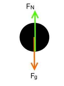

(a) The Earth may be considered to be a uniform sphere of radius 6.37 × 103 km with its mass of 5.98 × 1024 kg concentrated at its centre. The Earth spins on its axis with a period of 24.0 hours. (i) A stone of mass 2.50 kg rests on the Earth’s surface at the Equator.
1. Calculate, using Newton’s law of gravitation, the gravitational force on the stone.
2. Determine the force required to maintain the stone in its circular path.
(ii) The stone is now hung from a Newton-meter.
Use your answers in (i) to determine the reading on the meter. Give your answer to three significant figures.
F= GMm/r^2 and F= mw^2r
I got the solution for 1. 24.6 N and 2. 0.0842 N but I don't understand why is (ii) or the weight the difference between these two values? Why do we have to subtract Fg-Fc, aren't they supposed to be the same thing?

Ok step by step..
The first thing to note is that the stone is accelerating. Therefore the net force acting on the stone is not zero.
So we can draw our FBD..
The two forces acting on the stone are Fg and the normal force FN so we can write that as...
Fg + FN <> 0
In order to move in a circle the net force must provide the centripetal force Fc (=mv2/r) so...
Fg + FN = Fc
Rearrange to give the normal force...
FN = Fc - Fg
The weight call it FW (as measured by the Newton-meter) is the same magnitude as the Normal force but has the opposite sign so..
FW = - (Fc - Fg) = Fg - Fc

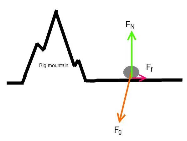

Taniaz said:
One last question, Fg and the normal reaction don't really act along the same line unless they're either at the top or the bottom of the circle. When they're on the sides, they make a 90 degrees angle with one another, then you can't do Fg-Fc can you? Because they're perpendicular to each other?
I can imagine a situation where Fg and FN aren't parallel. For example a stone near a mountain would experience gravitational force that wasn't perfectly vertical. Not to scale!..
In that case you might need to think about other forces such as Ff the force due to friction.
Your starting point would be as before, that the net force = Fc..
FN + Fg + Ff = Fc
(vector addition obviously)
You then rearrange it in the same way as before to give FN and hence FW.
FN = Fc - (Fg + Ff)
FW = (Fg + Ff) - Fc
Friction Ff can be calculated from the horizontal component of Fg
