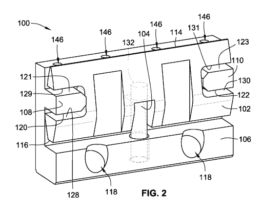

Short answer: BTDT.
Slightly longer answer: I've done a lot of work with measuring dynamic phenomena: forces, stresses, vibrations, speed, acceleration. I don't have a good example of an impact that saturated a 500 G accelerometer, but the figure below is an interesting example of just how large impact forces can be. It's from US Patent Application 20130184139. You can look up the application at patft.uspto.gov. Click on Number Search under AppFT: Applications, then enter the number. Part 102 is about 3/16" thick, slightly over 1" wide, about 2" long, and made of steel. Part 106 was made from Nylatron. Spring 104 is about the size and stiffness of a ball point pen spring. In use, part 102 is pushed down about 1/16", then released. The spring pushes it outward until part 102 hits the stops at 120 and 122. That impact broke pins 108 and 110. We were able to observe the impact using high speed video at 10,000 frames per second, and measure the impact velocity and duration. From that, and assuming elastic impact, the peak impact force was calculated at slightly over 100 lbs. Some FEA work with part 106 showed stresses that completely explained the failures.
