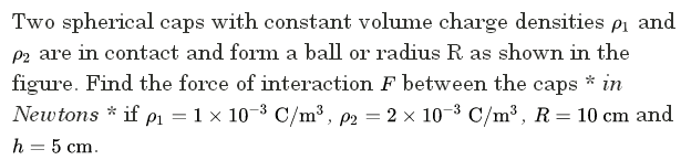

Force of interaction between caps
In summary, the conversation involves the attempt to find the force of interaction between two spherical caps with different charge densities. The approach proposed is to extend the larger cap to make it a complete sphere and replace the smaller cap with a cap of the same dimensions but with a different charge density. However, there are concerns about the validity of using a uniform electric field for the larger sphere and the expression for the volume element in spherical coordinates. Further clarification is needed in order to proceed with the problem.
Saitama
4,243
93
I can extend the bigger cap with charge density ##\rho_2## and make it a complete sphere. If I do this, I must replace the smaller cap of charge density ##\rho_1## with a cap (of same dimensions) of charge density ##\rho_1-\rho_2##. Now this doesn't look right to me because if I continue to find the force of interaction with the help of this new configuration, the force turns out to be attractive as ##\rho_1 - \rho_2## is negative where as the force should be repulsive. :confused:
Any help is appreciated. Thanks!
I'm not following you here.
Can you find the force of interaction for the case of equal densities ##\rho_1 = \rho_2##?
Then try to make a simple argument for dealing with the case of unequal densities.
Okay, let me explain with the help of a picture.
Consider a sphere with charge density ##\rho_2## (blue). Then I place a spherical cap of charge density ##\rho_1-\rho_2## (red) on it. This is equivalent to the given setup in the problem. Can you understand my approach now? Please let me know if anything is still unclear.
OK. I'm not sure how this way of looking at it helps. The cap with density ##\rho_1-\rho_2## will be attracted to the lower section of density ##\rho_2##. But don't forget that you would also need to include an additional repulsive force on a cap of density ##\rho_2## for a uniform sphere of density ##\rho_2##.
[EDIT: I would start with a uniform sphere of density ##\rho_1## and find the force on the cap (of density ##\rho_1##). You should then be able to tweak the answer to get the solution to the problem.]

To make the integral easier, it would be convenient to consider the force between A0 and S1. To that end, we need to calculate that between A0 and A1.
That's a nice recap (sorry for the pun) of the approach we were trying to take. We had gotten to the problem of finding the force of A1 on A0. But this is where Pranav seems to have either lost interest or been too busy with other things to continue.
Consider two small regions X, Y in A. X1 exerts a force on Y0, while Y1 exerts an equal and opposite force on X0. Thus, there is no net force between A0 and A1.
That's a nice and very succinct argument.
It follows that the force between A0 and B1 is the same as that between A0 and S1.
Yes, that's what I was hoping to get Pranav to see.
Using cylindrical coordinates with origin at the centre of S, and the z axis orthogonal to the A/B boundary, consider a point in A at (r, θ, z). What is the field at that point due to S1? What is the component of that parallel to the z axis?
I think Pranav did this calculation and his result is in post #13, although he chose the x-axis to be the symmetry axis rather than the z-axis.
Thanks for your contribution to keep this thread moving! I agree it's a nice problem.
Likes 1 person
OK, but I disagree with the answer in that post. I don't see any expression involving the volume of S. I get a pi-squared in the answer.
  • #31
Pranav used the known expression for the field inside S due to a total sphere of charge density ##\rho_2##: ##E=\rho_2r/(3\epsilon_0)##.
The z-component of this field is then ##E_z=\rho_2z/(3\epsilon_0)##. Since it only depends on z, you can get the force on the cap by integrating over disks.
##F=\int_h^R E_z (\rho_1\pi r^2) \,dz## where ##r = \sqrt{R^2-z^2}##. I get the same result as Pranav.
Likes 1 person
  • #32
Sorry for my indifferent behaviour towards the thread but I have a genuine reason of doing it. I was busy with my exam which was on 6th April and the subsequent days were also busy for me, I had no intention of dumping the thread. :redface:
Thank you haruspex for keeping the the thread alive!
Yes, I am agreed. Thank you for stating this, I don't think I could have thought of this argument. :)
I calculated this in #13 and plugging the values doesn't seem to give me the right answer. :confused:
  • #33
Hope you did well on your exam!
Uh Oh. Well, maybe haruspex can set us straight. Did you get a force of 3.33 N?
Likes 1 person
  • #34
Woops, looks like I did not correctly input the values in the calculator. Thanks TSny and haruxpex! 3.33 N is the correct answer. :)
  • #35
Ah, OK. I did it from first principles, but missed a cancellation of π.
