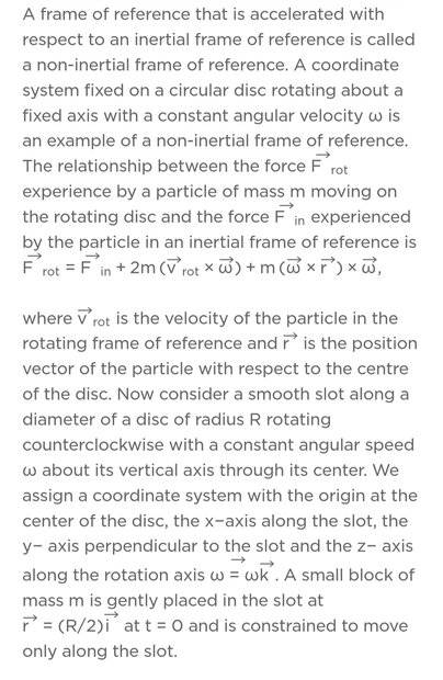

Equation of force acting on a particle placed on a disc in the rotating frame of reference
$$|\vec F_{centri}|=m\omega^2r$$
How is the equation for the force derived?
##\vec F_{rot}## should be sum of ##\vec F_{in} \pm \text{ pseudo force }## which is the centrifugal force.
SO $$\vec F_{centri}=2m(\vec v_{rot}\times \vec \omega)+m(\vec \omega\times \vec r)\times \vec\omega$$ which does not seem incorrect
Why is it epressed in such a way?
What do the ##2m(\vec v_{rot}\times \vec \omega)## and ##m(\vec \omega\times \vec r)\times \vec\omega## terms represent??
Isn't the only pseudo force acting on the particle the centrifugal force ##=m\vec \omega \times (\vec r \times \vec \omega) \text{ ?}##

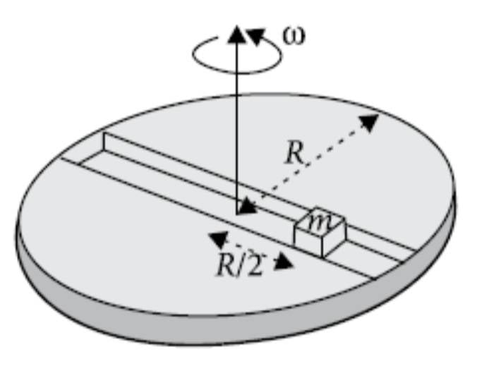

To expand just a little bit on the reply above: The centrifugal force is the only pseudo force acting on a particle at rest in the rotating frame, since the Coriolis force is linearly dependent on velocity in the rotating frame.

However, one answer is that ##X## is the force from the rails pushing on the sliding block, thereby constraining it to follow a straight path in the rotating frame or constraining it to follow a spiral path in the inertial frame.
That sideways force from slot on block is a real interaction force. Like the centripetal force, it exists in all frames.
What does the ##X## force do in this situation from the point of view of the inertial frame? It adds energy to the sliding block, thus explaining its increase in kinetic energy.
In a different scenario with tangential motion as seen from the rotating frame, the Coriolis pseudo force can act either to add to (if the velocity is spinward) or to subtract from (if the velocity is anti-spinward) the centrifugal pseudo-force. As such, the corresponding real force would be the centripetal force.
In yet another different scenario, suppose that we eliminate the slot and allow the block to slide frictionlessly on the surface of the disc. Now there are no interaction forces of any kind. Now the combination of centrifugal and Coriolis force explains the spiral (or circular) path of the block as viewed from the rotating frame, even though the path in the inertial frame is uniform motion along a line (or a state of continuing rest).
[And now the negative potential energy in the centrifugal force field explains the gain in kinetic energy of the outward spiralling block. Or the loss in kinetic energy of an inbound block before it eventually spirals back out]

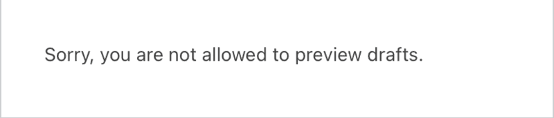

jbriggs444 said:
This link may work better. [I'll delete this post if I see that the link in #10 is working. #10 seems to link to a preview rather than to the actual Insight].
Thanks, but the original link work fine with my browser. Maybe it doesn't work with all browsers.
On edit
Problem fixed. See post #15 by @Orodruin.
You linked to the preview page instead of the published page. You have permission to view it because you are the author. The rest of us do not have that permission.
Likes jbriggs444 and kuruman
Good catch, thanks. I corrected a typo I saw in an equation and lost track of what window was what. I should have read @jbriggs444's post more carefully. Problem fixed.
Since Coriolis Force has a bending/deflecting effect, in this problem, it has no effective effect?
It is hard to say. What is an "effective effect"?
The Coriolis force is introduced by choosing to use rotating coordinates. That is to say that it is conjured into existence with pencil and paper. In some sense, the only effect it can have is changing the squiggles on a piece of paper. Or in a textbook.
Any measurable physical effect that is attributed to the Coriolis force must be attributed instead to something else if we choose to work purely in an inertial frame.
How would you go about running a physical experiment with the Coriolis force turned off?
Likes jbriggs444
Bad choice of words on my part.
What I meant was since the block is constrained to move in a slot, the Coriolis force can't really have it's bending\deflecting effect?
Your thread started out with a question about forces acting .
Ok. I can agree with that. In the same sense that pushing on a wall has no effect.

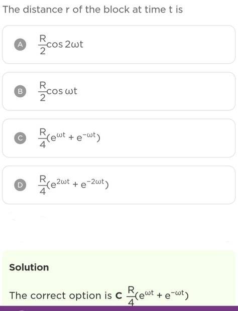

Since the block is constrained to move in the slot, (and like you said the Coriolis Force didn't affect its movement) I was expecting an equation of SHM. $$\dfrac{d^2r}{dt^2}=k\omega^2r$$ where k is constant of proportionality.
I was expecting one of the trigonometric options.
But the option C is marked correct.
The net force in the rotating frame is always radially outward. The outward force increases as the outward position increases.
That is not negative feedback. That is positive feedback. You should expect runaway behavior.
It is almost the same second order differential equation as for simple harmonic motion. But a sign is reversed.
A second order linear homogeneous differential equation like this one will have a characteristic equation that is a quadratic. If it has two real solutions, you get two exponentials as solutions to the original equation. If it has two complex solutions, you get trig functions as solutions. Complex exponentials such as ##e^{i\theta}## and trig functions are intimately related.
If the middle coefficient in the characteristic quadratic is zero (as in this case), it is the difference between solving ##x^2 = 1## (and getting two real roots) and solving ##x^2 = -1## (and getting two imaginary roots).
You have been exposed to solving linear homogeneous differential equations by finding roots of their associated characteristic polynomials, I hope?
