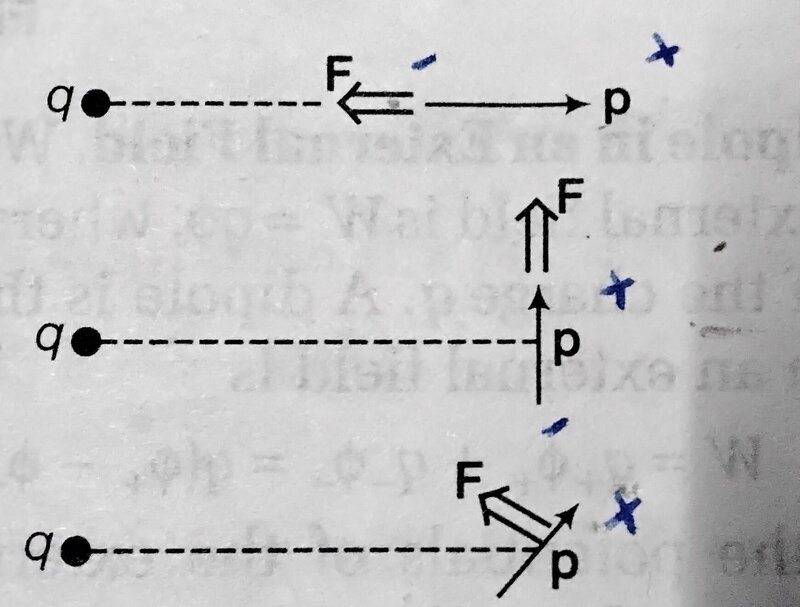

Prove that the direction of the force on the dipole is as indicated in the diagram
F = partial derivative of p* E
I have figured out how the force is towards left in the first case. I think it is due to the larger force on - charge.
Please help me out with the second and third case.
Likes Delta2
Something looks off (i.e., "wrong") with the problem statement. I'm hoping your instructor didn't give you a bad problem, but it's not unheard of. Then again maybe I'm missing something myself.
From what I can tell, middle and bottom parts look wrong, although maybe the middle part is a trick question.

The question is to find the net force on the dipole due to the positive charge q (on the left).
They are not separate systems
collinsmark said:
Can you use my equation in Cartesian coordinates (above) to show that there is something wrong with the middle and bottom figures?
I don't know where to start.
I think the drawings are correct. There are three ways to see this
  1. Work out the formula explicitly
  2. Consider the dipole as two point charges
  3. Consider the force on the point charge from the dipole field (equal and opposite Newton pair) if you can picture the dipole field
For the OP: do all three!
Likes collinsmark and Shreya

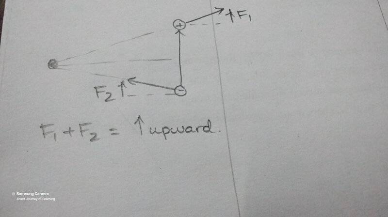

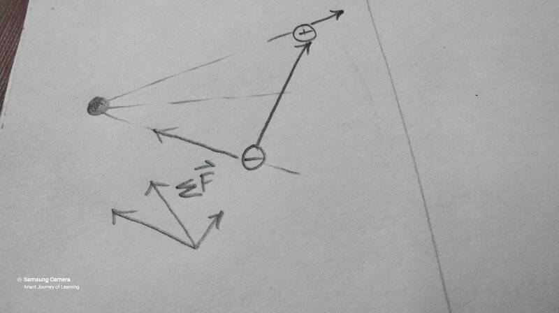

For the second case, can you please check if my reasoning is right?
Likes hutchphd and collinsmark
I have not consider the perpendicular forces, since they cause a torque and not a field.
Likes hutchphd
collinsmark said:
But I don't think the middle figure (diagram) and the bottom figure (diagram) are correct.
It's from the book titled "Basic Laws of Electromagnetism" by IE Irodov
Yes, you are correct. I was misinterpreting the problem statement, after all. Sorry about that.
That's right right idea. :smile:

Will this work in the 3rd case?
