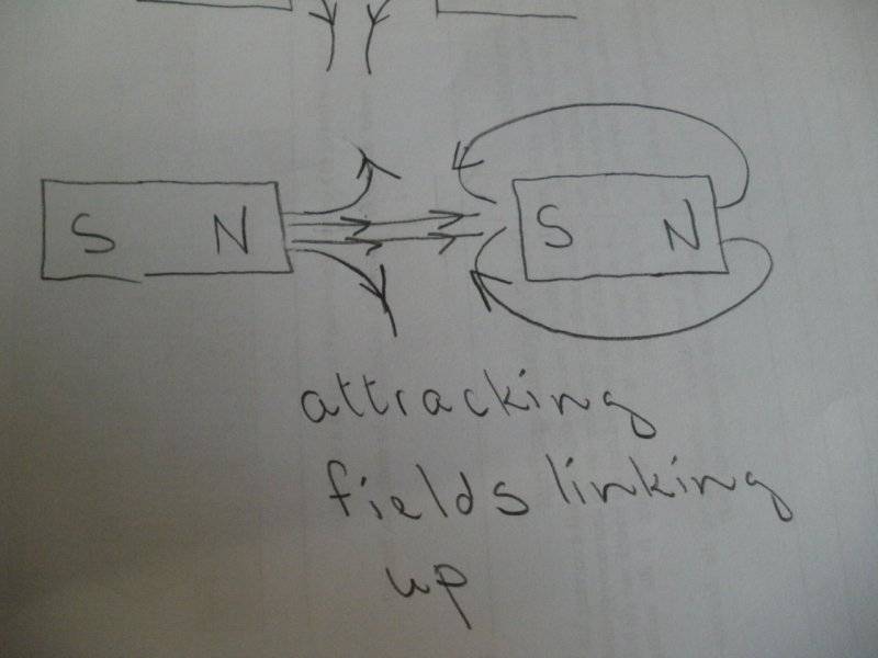

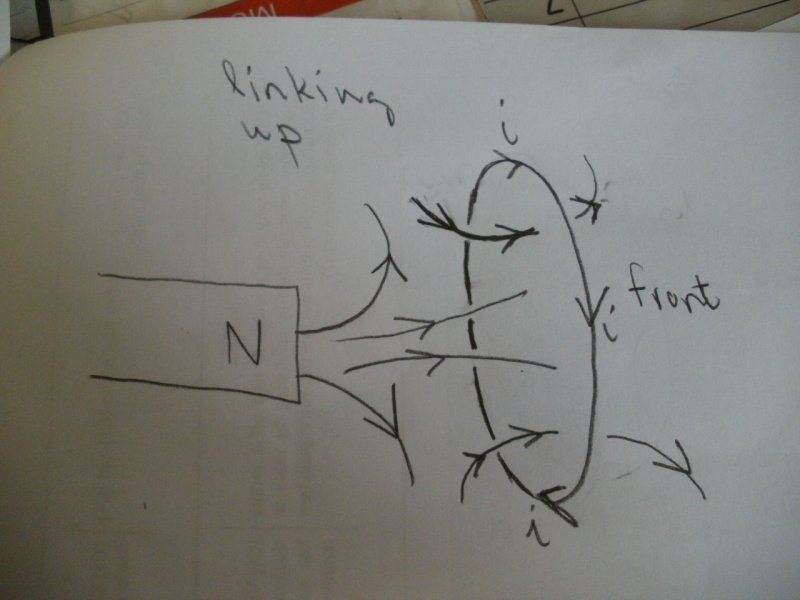

The induced magnetic field from the current in the coil is in the same direction as that of the magnet that is removed
from the coil. The coil thus acts as an additional magnet. It attracks the magnet as it is removed from the coil.
The source of the force is thus the coil. This effect was also used in old car speedometers - Arago's rotation effect
http://www.physics.montana.edu/demonstrations/video/5_electricityandmagnetism/demos/aragosdisc.html
https://prezi.com/dyvhcumzt6k_/electromagnetism/
The two objects become locked together and a force is required to separate them. Hope this is what you wanted to know.
