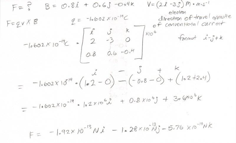

What is the force on an electron with a velocity v = (2i – 3j) Mms-1 in a magnetic field B = (0.8i +
0.6j – 0.4k) T
F=qvBsinθ
using cross product I got: (1.92i + 1.28j + 5.77k)10^-13 N which is the listed correct answer.
My question is since this was an electron, why the value wasn't negative 1.92i, etc. Wouldn't the charge have contributed to the direction? Can someone please explain this to me?
Thanks
The sign of q in the vector qvB contributes to the sign of the cross product answer...Can you show your work including the calculation of the cross product?
Likes chopnhack
sure
Yeah, your work and your answer with the "-" signs looks right to me. You are saying that the "+" answer is listed as the correct answer?
Yes, but the professor has been known to make mistakes.
Likes berkeman
Does he/she have office hours before this is due? Show them your work and ask politely if you've missed anything...?
Likes chopnhack
I have done just that. Hopefully I can get a clarification. It's very difficult to learn magnetism while correcting typos!
Thank you!
You're welcome. Just keep doing the math, and you should be fine. :smile:
