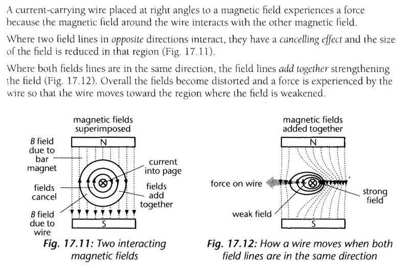

This question comes under the familiar topic "force on a current carrying wire in a magnetic field".
You all know the Lorentz force and [itex]F=LI\times B[/itex]. So I'm teaching a high school class on this and a senior teacher tells me the students will need to explain the force on the wire for their exam in terms of the modified B field lines (due to sum of B fields of the current in the wire plus the magnet). I could not teach this because I did not know how to explain it.
Here's the sketch in words: B field N to S horizontal (left to right say). Current in wire coming at us out of page. RH Grip Rule field around the wire anticlockwise. This adds to the magnet field. Result: Field lines above wire partially cancel. Field lines below wire reinforce. High field below the wire, weak field above it.
From what I could make out the textbook seemed to be trying to explain the upwards motion of the wire being due to movement of the wire from "high magnetic field region to low magnetic field region". Almost as if it were a magnetic field pressure effect.
But I've always thought this force on a wire carrying a current in a B field was just simply the Lorentz force on the charges. How can magnetic pressure or "movement from high to low field intensity" be the cause? Is it additional to the Lorentz force? Is it different and does it dominate the Lorentz force?
I can see that the field around the wire is not uniform because of the superposition of the magnet's field wit the current's field, but is the lifting of the wire still not just the plain Lorentz force?
Any enlightenment would be welcome.
PS. I'll post the textbook text and figure in a mo' once I scan it.)
Here's the textbook page (see attachment):

This teacher is misled. So was the creator of the attached thumbnail drawing. Magnetic fields act in superpostion--that is, a direct sum. The magnetic field locally induced by the wire has no force back on the wire. So you need only consider the external field.
Koss's question is a valid question, and the teacher is not misled. The fact is : both the explanations in terms of the Lorentz force on the current carrying conductor, and the force due to the interaction of the external and current carrying magnetic fields are equivalent. I hereby provide the proof that I just worked out as followed.

entphy said:
I guess the question is which direction is the force on a current carrying wire directed due to its own induced magnetic field interacting with the external applied magnetic field, as there would be no force without the 2 magnetic fields interacting.
No. Magnetic fields don't interact. B_total = B_1 + B_2, a direct sum. There is no product term.

Hi folks, yes I am still following this thread.
I thank both Phrak and entphys for their contributions. I'm not so sure there is a deep disagreement. Many physical problems have equally valid, yet seemingly different, explanations. Maybe there is just a language issue in the discussion above?
I'll try to summarize what I've learned form this thread so far. Correct me please if I'm still misguided :-)

My take on Phrak is that "yes" magnetic fields do not interact by themselves, they add in superposition, just as entphys remarks. Both of you I think, agree that magnetic fields, once superposed, do act on moving charges. So we all agree that the Lorentz force explanation is valid. My present understanding of this explanation is that since without the external magnetic field the current carrying wire does not self-interact, the effect of adding the external magnetic field cannot (by linearity of superposition, i.e., adding up total field) result in any more of an effect than the Lorentz force due to the external B field---as if the field of the current carrying wire did not self-interact.
So teaching my students this version of the force on the wire is OK. Brilliant.
B. Field tension explanation.
Without resorting to tensors, entphys gives a sound derivation of the force on the wire in terms of the superposed fields. This is nice because it gives a concrete form of the Lorentz force in terms of the gradients of the fields. But in the absence of moving charges there is, of course no mass, hence no force, so this does not imply any magnetic field "interaction", it is simply an equivalent way of describing the Lorentz force without using the current, and instead using the magnetic field H generated by the current. All I need to do is explain to my students that to have the field H there needs to be a current, hence charges, hence a force on them---which can either be calculated simply using the Lorentz force and the Right Hand Rule, or equivalently, but by more complicated math, by using the B and H field gradients.
The picture implied by the textbook is thus not totally misleading, it is indeed "as if" there is a tension in the field lines, but of course these are fictions if we take QED seriously, which my students already understand, so all should be good for my classroom discourse I think.
