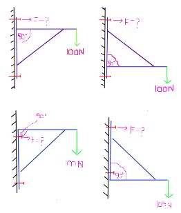

In summary, two friends have an disagreement about the amount of force needed to screw a top bar into a wall. One person argues that there is more force needed in the tie scenario, while the other argues that the force is the same in both scenarios. If we assume the lower screw as the pivot, then the moment around it and the pull on the upper screw are the same in each case. If we assume the lower screw as the pivot, then the moment around it and the pull on the upper screw are the same in each case.

Please excuse my crappy drawings...
The measurments are not important only that it is the same frame either with strut or reversed for tie.
The difference in opinion is simply that one says there is more force pulling the top screw from the wall in the tie senarios of each design, while the other says there is no difference in force on the top screw either way round.
(We are both in our late 30's so it was some time since working out any actual equations- let alone remembering which ones are relevant)
Errr...vectors, moments..??
It's been too long but only exact maths is going to conclude this little discussion!
Please, please can you prove the error in one of our heads and make the other safe in the knowledge they are not a complete idiot!
Thanks A.T.,
Would the pivot not be the bottom end of the bar against the wall and does that make any difference?
What equations need to be used to work out exact numbers for the force acting on the top screw in both senarios for each design?
That might be more sensible. Then both screws are pulled.
Not between the designs, if the distance of the screws to the bottom end of the bar is the same for all of them
http://en.wikipedia.org/wiki/Torque
You compute the torque created by the given force (M = F1 * r1) and then you use this torque to compute the pull force on the screw (F2 = M / r2). Where r is the shortest distance between the pivot and the line of action of F.
Thanks again A.T., I just need to try to work it out when I have time and will maybe show my workings here for probable corrections!
