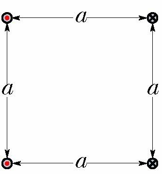

1. Homework Statement [/b]
Suppose in the figure that the four identical currents i = 13 A, into or out of the page as shown, form a square of side 64 cm. What is the force per unit length (magnitude and direction) on the wire in the bottom left hand corner? (N/m) Take the positive y direction as up and the positive x direction as to the right.
What is the magnitude of the force per unit length?
(diagram is in following post)
What is the x component of the force per unit length?
What is the y component of the force per unit length?
F= muo*i1*i2/2*pi*d
F= 1.26E-6 * 7A * 7A/ 2*pi* sqrt(2*.64m) = 1.095E-4
i do not know if i am doing this right at all...but this answer is wrong for the the first part..
