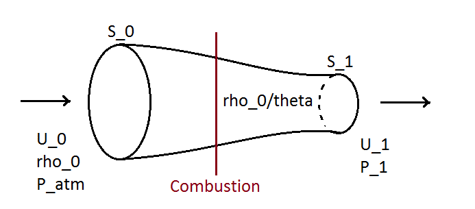

Consider an aircraft turbine as in the figure below. In the reference frame of the turbine, air of density ##\rho_0## comes into the turbine with speed ##U_0## through the entrance with cross sectional area ##S_0##. In the combustion zone, air is mixed with the fuel and burned (contribution of the fuel to the gas mass may be neglected). The density of the burned gas is ##\Theta## times smaller than the initial air density (typically ##\Theta \gg 1##). The burned gas leaves the turbine through the exit with cross sectional area ##S_1##. Find the thrust (the force produced by the flow on the turbine). Assume for simplicity that the flow is stationary, uniform over any turbine cross-section and incompressible, and that the gas density changes only in the combustion zone. Disregard pressure modifications in the combustion zone.

We begin by splitting the force term into two parts ##\mathbf{F} = \mathbf{F}_p + \mathbf{F}_{ByWall}##, where ##\mathbf{F}_p## is the pressure force on the fluid at the openings and ##\mathbf{F}_{ByWall}## is the pressure force on the fluid from the turbine (walls and fans). We use Newton's third law to obtain the thrust as ##\mathbf{F}_{thrust} = -\mathbf{F}_{ByWall}##. Using (3) with ##\hat{\mathbf{x}}## to the right in the figure, we get
$$\mathbf{F}_{thrust} = -\oint _S\rho\mathbf{u}(\mathbf{u}\cdot d\mathbf{S}) + \mathbf{F}_p = (\rho_0 U_0^2 S_0 - \frac{\rho_0}{\Theta}U_1^2 S_1)\hat{\mathbf{x}} + (P_{atm}S_0-P_1S_1)\hat{\mathbf{x}}.$$
Using now (1) and (2) with ##h=0## we find that
$$P_{atm} + \frac{1}{2}\rho_0 U_0^2 = P_1 + \frac{1}{2}\frac{\rho_0}{\Theta} U_1^2 \Rightarrow P_1 = P_{atm} + \frac{1}{2}\rho_0 U_0^2\Big(1-\frac{S_0^2\Theta}{S_1^2}\Big).$$
Thus,
$$\mathbf{F}_{thrust} = (\rho_0 U_0^2 S_0 - \frac{\rho_0}{\Theta}U_1^2 S_1)\hat{\mathbf{x}} + (P_{atm}S_0-(P_{atm} + \frac{1}{2}\rho_0 U_0^2\Big(1-\frac{S_0^2\Theta}{S_1^2}\Big))S_1)\hat{\mathbf{x}} = (\rho_0 U_0^2 S_0 - \frac{\rho_0}{\Theta}U_1^2 S_1 - \frac{1}{2}\rho_0 U_0^2\Big(1-\frac{S_0^2\Theta}{S_1^2}\Big)S_1)\hat{\mathbf{x}} + P_{atm}(S_0-S_1)\hat{\mathbf{x}}.$$
Now, there are quite a lot of terms here and it can be simplified a bit, but what I don't understand is the last term in the expression for the thrust, ##P_{atm}(S_0-S_1)##, which comes from considering the pressure forces on the fluid at the entrance and the exit. If we put the velocities to zero, we get thrust from nothing, which doesn't make sense. Is the way I split the force ##\mathbf{F}## incorrect?
I can't understand the problem statement . It appears to be mostly gibberish .
There are in any case some quite simple standard methods for estimating engine thrust .
