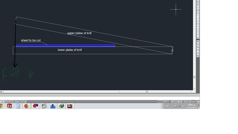

hi every one
can in you help me in finding the required force to cut sheet metal electrically as shown blew

One problem with the design shown is that the blade angle to the cutting surface is not constant (as it is in conventional metal shears); and, as a result the required cutting force will increase as the cutting proceeds through the shearing process.
Think the worse case will be just as the blade starts to cut the last bit. Make a drawing of the blade in that position and you can work out how much of the blade is still in the metal (and how much has already cut through it). Put that length into the equation for the shear force.

Make the drawing I suggested in #4 to work out the length of the blade in the metal.
eng_taha_a: You have been given the necessary information to perform the calculation so it is time for you to do so, rather than to ask for someone else to perform this for you.
CAN YOU MAKE IT MORE CLEAR
SORRY
When you start cutting a sheet only a small part of the blade (near the hinge) makes contact. As the cut continues more of the blade will be cutting. The part doing the cutting moves away from the hinge. Eventually it reaches the edge of the sheet that is furthest from the hinge. In that position some of the blade will have gone right through the metal so it will no longer be cutting. The force required on the handle will increase as the cutting point moves away from the hinge.
Draw the blade at the point where the cut just reaches the edge of the sheet furthest from the hinge.
Post a sketch and I will tell you if it is correct.
Likes eng_taha_a

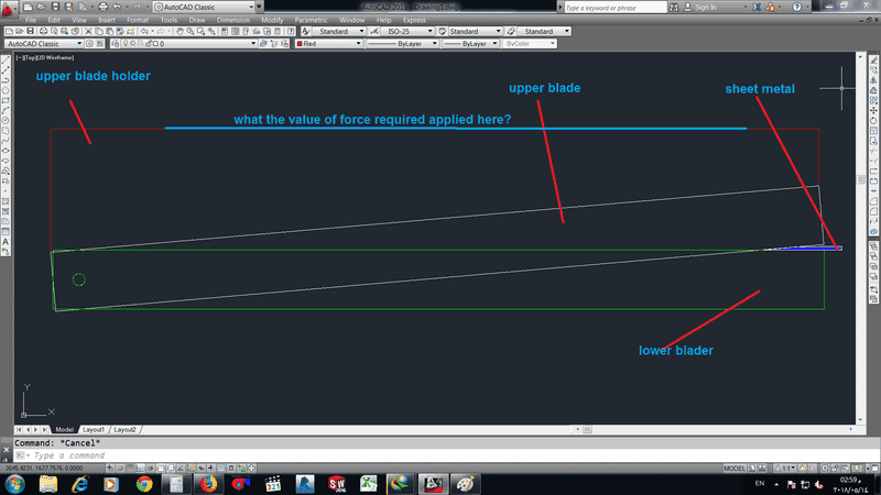

this is my best guess
wish you help me more
thanks

Yes that looks correct. Now think about the area in blue and the equation in post #5.
the area in blue will change from start from 1300 mm at the start of cutting process and ends at the end of the cutting process and the change will be in mm , and according to this equation the value of shear force will change as the area changes ?

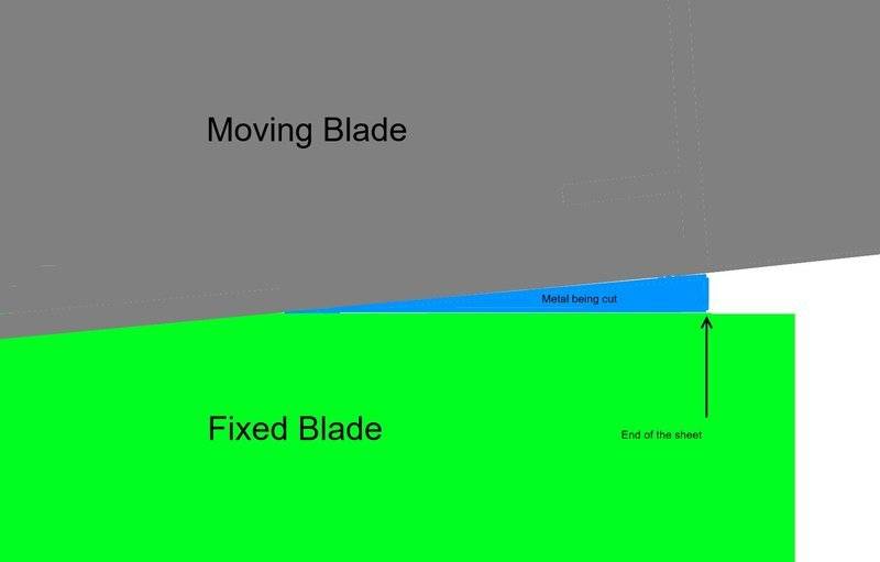

I've had a closer look at your drawing and there is a small mistake. We want the area shown below in blue. See how the moving blade has reached the end of the sheet. In this position it is cutting furthest from the hinge.

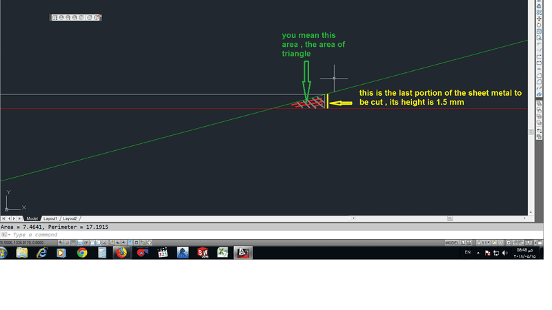

but if so the area of this triangle is too small because the sheet thickness is 1.5 mm
so if the area is 8 mm2 , UTS is 370 n/mm2 then the force = 0.7*370*8 = 2072 N
is it right ?

eng_taha_a said:
but if so the area of this triangle is too small because the sheet thickness is 1.5 mm so if the area is 8 mm2, UTS is 370 n/mm2 then the force = 0.7*370*8 = 2072 N is it right ?
I cannot check your calculation without more dimensions. For example I need the height of the sheet above the hinge and the depth of the blade below the hinge.
If the area of the triangle is 8mm2 and the height is 1.5mm then the base must be 10.7mm. That means the blade angle in that position is about...
Tan^-1(1.5/10.7) = 8 degrees.
The force you calculated would be the force required at the cutting point which is roughly 1300mm from the hinge. The force on the blade handle would be less due to leverage.
