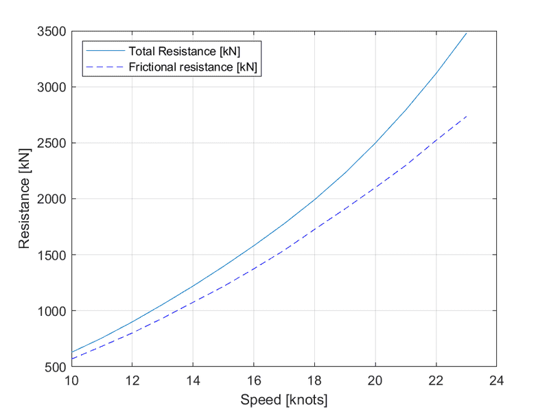

Work done is force * distance; so we can estimate the total drag forces from the 40 MW power and the speed of 25 knots.
First, convert to SI units. Velocity, 25 knots = 12.86 m/s.
Then compute the force, 40 MW / 12.86 m/s = 3.11 MN.
The force required to pull a cruise liner or cargo ship will be the same as the force needed to push it. My initial estimate is 3 million Newtons.

A drag coefficient of 0.004 applies to the wetted area of a ship's hull, not to the cross-section.
Length 400 m, Beam 61.5 m, Draught 17 m.
Wetted area = 400 * ( 17 + 61.5 + 17 ) = 38200 m2
Drag = 0.5 * 0.004 * 38200 * 100 * 1200 = 9.168 MN.

Drag = 0.5 * 0.004 * 31400 * 100 * 1200 = 7536000 N = 7.5 MN
This means I can use about 750 N force to move Cargo liner at 0.01 m/s speed considering there is no other drag force acting on ship.

No, that's not how it works. Just for reference, this is the measured (measured on model scale and extrapolated to full scale) resistance for 'a' ship which is a little bit smaller than the ship that is referred to in the first post (Length 390m, beam 60m, draught 16m, displacement 245Mt) which I happen to have laying around:
This ship needs about 35MW at 20 knots in ideal conditions (no wind, no waves, clean hull). This number also depends on the propeller efficiency of course.
So the resistance increases continually with speed. Note that:
  • The total resistance is higher than frictional resistance because of wave resistance. The frictional resistance here also includes a form factor resistance due to the ship hull not being a flat plate.
  • The difference between frictional resistance and total resistance also increases since wave resistance increases with speed.
  • This is the minimal force that you need to apply to keep the ship at that velocity. The actual force may be larger due to interaction effects (the thrust of a propeller needs to be larger due to something called 'thrust deduction', which is the part of the thrust that is lost because the resistance of the ship is increased due to the propeller doing its work and generating a low pressure area on the aft part of the ship) or due to weather effects (wind, waves) etc.
Likes PeroK and anorlunda
