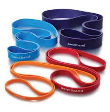

The bands are loop bands as shown below:
I’m guessing that using them doubled over vs. just one side means that the force required in the above scenarios is just multiplied by 2?

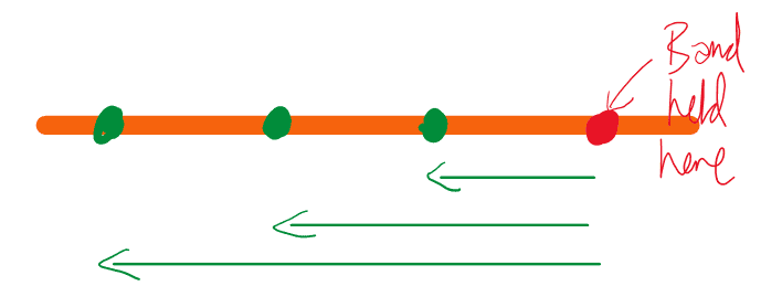

Ah OK. So, based on the below diagram:
Imagining that I am holding the band with my right hand at the red dot (or indeed even stepping on the band with a foot), and pulling with my left, the force the band exerts at each point that I pull along the band (green dots) can be worked out using the following (just Googling around, hope I’ve rearranged it correctly!):
F = E(∆L * A)/Lo
where
F = force
E = Modulus of elasticity of latex rubber
∆L = length being pulled
A = cross-sectional area of band
Lo = original length (i.e. distance from my left hand to right hand)
Have I got this right?!

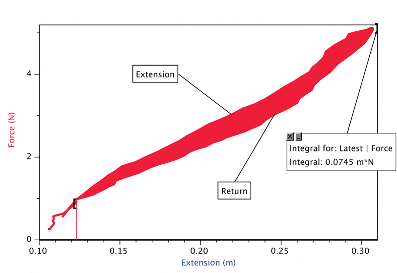

I haven't taken the time do the experiment but it was my understanding that rubber (and probably latex) bands don't follow Hooke's Law all that well. There is a change in the elasticity with stretching, a sensitivity to rate of applied elongation, and some amount of hysteresis. I guess for talking about the general concept using Hooke's Law is close enough but if you were trying to predict a force you might be disappointed in the accuracy in this case.
Or am I wrong?
Likes dlucaswood
You are right.
However, even if it is non-linear, the force needed will vary with the percentage expansion rather than with the raw amount of expansion.

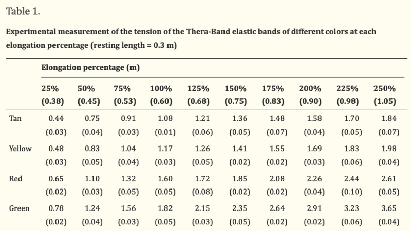

But it's possible that the non-linearity is more than trivial. Consider the Theraband elastic exercise bands. They are very popular. Their force/elongation values were measured (and compared to the manufacturer's values) in this paper. As you can see stretching one 100% beyond its initial length results in a force only about 40% greater than stretching 50%.
(values are in kg force)
Likes russ_watters

Yes, that is right, for an ideal elastic band.
