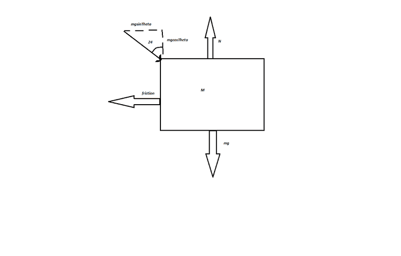

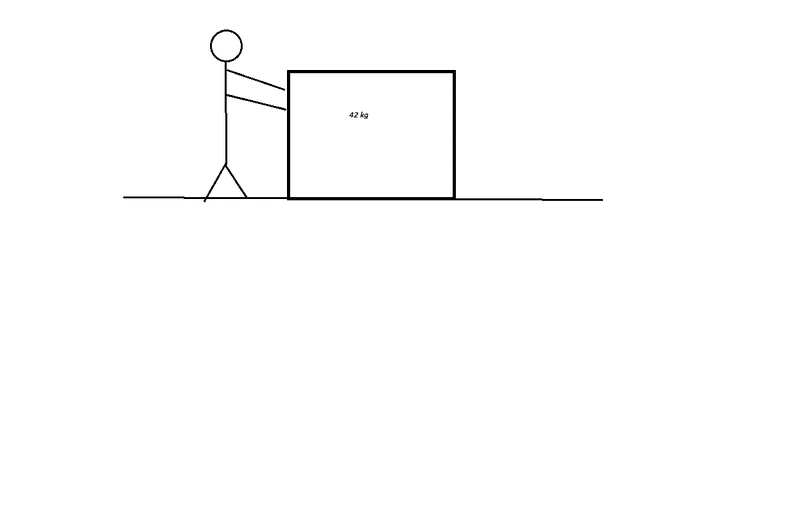

A crate has a mass of 42.0 kg. The coefficient of static friction between the surface and the crate is 0.422. The coefficient of kinetic friction between the surface and the crate is 0.3.44. If a person pushes the crate by pushing down at an angle of 24°, what is the minimum force it would take to get the crate moving and then keep it moving? Suppose instead a rope is tied to the box and it is pulled at an angle of 24° above horizontal, what minimum force is now required to start and to keep the crate moving?
ƩFy=ma_y
Ʃx=ma_x
Diagram
https://www.physicsforums.com/attachments/56753
FBD
so
Ʃy = ma_y
the forces acting in the y direction are N...mg...and mgcosθ
So wouldn't that be
N - mgcosθ - mg = 0? because there is no acceleration in the y direction?
and
ƩFx = ma_y
the forces acting in the x direction are mgsinθ and friction
so would that be
mgsinθ - static friction = 0? Because we just want to get it moving not accelerate?
i know static friction is μ_s N
just a little confused on how to start here...any hints would be greatly appreciated
typo in the equations
ƩFx = ma_x
and
diagram didn't post
no hints with this one?
So wouldn't that be
Why have you got mg twice here? The second term should involve the applied force.
(same problem with the x-components)
Also, I'm not sure that the angle is the right way round - should it not be the other angle in your triangle?
Think of what is happening if you increase F until the crate is just about to move.

i thought that since the force of gravity is acting straight down m*g ...that it would be in the y-component equation?
as far as the angle...i'm not too sure...we just started adding the angle component into the questions...before it was just horizontal and vertical...
then what should the angle be? did i put the (dashed lines) components in the wrong direction?
i'm having a hard time with the angle portion of it...i tried to look for examples of it...but it didn't help TOO much
Yes, that's the -mg part.
The -mgcosθ part should be -Fcosθ, where F is the force applied by the person.
You also need to make a similar change to the x-component equation.
For the angle, just keep it the way it is in your free-body diagram for the moment.
Then you can combine both equations to solve for the applied force F.
For clarification, yes, mg, the weight of the crate, acts down in the y direction, and the Normal force, N, acts up in the y direction. But as ap123 pointed out, the applied force at the corner..the person's pushing force.. that should be designated as F, with components F sin theta and F cos theta, not mg sin theta and mg cos theta which you incorrectly indicated on the sketch
Again as ap123 has noted, the angle you have shown as 24 degrees is 66 degrees , since the 24 degree angle is presumably with the horizontal, not the vertical, although perhaps not so clearly stated in the problem.
Solve the 2 equations for the 2 unknowns, F and N.
