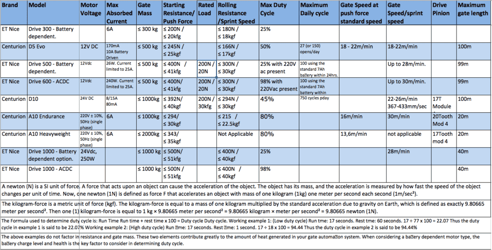

Made this comparison of the various models and their power output.
Not sure what is going on here.

Sorry for the confusion. Well spotted, the "...not exceeding 10Kg during running" came in an email from a supplier, but when comparing the specs of different models in the published manuals, I didn't find any reference to 10kgf.
Yeh, was thinking that the force to overcome resistance would be just a pinch more than the force to counter the mass of the gate+the additional weight due to the incline...
How much additional force to set it in motion, and how much force to keep it in motion do you think is reasonable?
I came across Steven Holzner's article on "Calculating the Force Needed to Move an Object Up a Slope" Physics I For Dummies, 2nd Edition. But I've just scanned it and need a bit more time to see and apply it.
Coming back to the table I'm keen on using the ET Nice Drive 600m, well priced and their service centre is close by, which they recommend every 18 months.
I want the gate design mass to comply with the motor's output, a 41kgf initial push to set in motion, and 30kgf to overcome resistance and keep moving! With a little extra for bad weather conditions. :rolleyes:
