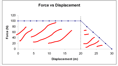

If the following Force v. Displacement graph is for a 9.9kg object and it's initial velocity is 28.6 m/s the what is its velocity at 30 m?
I am not certain that i am even using the right equations with this but:
W = fd
KE = 1/2mv(final)^2 - 1/2mv(initial)^2
I thought since W=Fd and work is proportional to kinetic energy, which is
KE=1/2mv(final)^2 - 1/2mv(initial)^2 and i then could substitute in the Fd, making the new equation:
Fd = 1/2mv(final)^2 - 1/2mv(initial)^2
This could then be rearranged to find final velocity:
sqrt { (Fd + 1/2mv(initial)^2) / 1/2m } = v(final)
Only the issue is that i do not know which F to use to find the final velocity at d=30meters. Because if i use the 0 the whole Fd cancels out, and i get the wrong answer. But if i use 100 then it comes out as larger than the initial velocity, which is not possible as it is losing speed due to lack of force after 20 meters.

thanks, haha so i was way off, isn't work then supposed to be the area under the line on the graph?

As the force changes over time, The best way to find the work in graphs is by getting the area
You have a triangle and a rectangle. Find the area and sum it up. You will end you will the the work done

And do i use the numbers of the x and y axes to find area? in this case the rectangle being 100x20 and the triangle as 1/2x100x10 ?
i keep getting an answer larger than the initial velocity of 28.6, is that at all possible?

I got 2500 for the work, is that correct?
I haven't calculated the velocity but it should be larger than the initial. Work is adding energy to the system. You add more energy this energy will be kinetic. While the mass and 0.5 obviously don't change then the only thing that will change is the velocity.
and the work is 2500 right :D
So yes it should be larger.
Yes. So, show us your detailed calculations for getting the final velocity. Incidentally, what are the units.
Likes df102015
W = 1/2mv(final)^2 - 1/2mv(initial)^2
2500 = (0.5 x 9.9 x V^2) - (0.5 x 9.9 x 28.6^2)
2500 = 4.95V^2 - 4048.9
6548.9 = 4.95V^2
1323.0 = V^2
36.4 = v(final)

I didn't check your arithmetic, but your approach looks OK.
Likes drvrm and df102015
Thank you, i got the right answer, just checked it! (:
