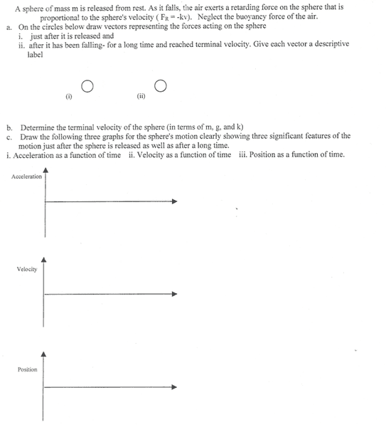

In summary, you were given the equations k:constant, v:velocity, m:mass, and g:gravity. For part (a), you correctly used the equation F=ma. For part (b), the equation Vt= √(2mg/CρA) is not relevant and you should use FR=-kv instead. For part (c), you can either sketch or calculate the graphs to show how the force and velocity change with time.

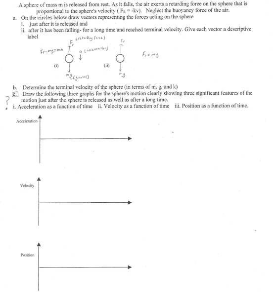

part a.

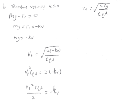

part b.

I do not know if i am doing this right and i do not understand how to do part c. If you know how to do this please explain
Welcome to the forum! You've got part (a) correct.
But for part (b), I don't think the equation Vt= √(2mg/CρA) is relevant. You were explicitly given that FR=-kv, so this is the equation you should be using. In fact, I think you got the answer for (b), before you started using that other equation for the terminal velocity.
Part (c) is a bit trickier. You could either roughly draw what happens, or explicitly calculate the form of the graphs, then draw them.
