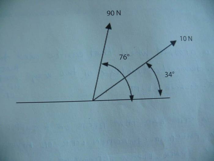

A body is acted on by two forces. Find the magnitude and direction of the resultant force by using the mathematical method. I'm not sure if I've done this correctly, any pointers would be appreciated :)
Also what is the angle between the two vectors? Is it 90 or 76 degrees?
Not sure how to describe this in words so I have the image for the diagram.
http://s3.postimg.org/jkti9aqkj/P1130367.jpg
Working out the first triangle.
x=cos45 x 90 = 63.64
y=sin^^^^^^^^^
Working out the second triangle.
x=cos45 x 10 = 7.07
y= sin^^^^^^^^
So for the system
x=63.64 + 7.07= 70.71
y= 63.64-7.07= 56.57
√70.71^2+56.57^2 = 90.554 N
Direction
Tanθ = opp/adj
=70.71/56.57
=1.25
Tan-1 1.25 = 51.34° above the horizontal.

Look at the picture. You see the magnitudes of both vectors and the angles they enclose with the x axis. What are they? ehild
The angle between them is 42 degrees?
Yes, it is. But why do you need it?
Write out the "relevant equations". How do you add vectors by components?
ehild
Is this the possible equation? sqrt((10cos 34°+ 90cos 76°)^2 + (10 sin 34° + 90sin 76°)^2)
Yes, it is the magnitude of the sum vector.
ehild
So it = 97.66 N? The resultant force?
Now I need to find the direction.
The force is a vector, so the magnitude of the resultant force is 97.66 N.
Yes, you have to find the angle it encloses with the positive x axis.
ehild
The direction is (10 sin 34° + 90sin 76°)/(10cos 34°+ 90cos 76°) = 3.09 degrees?
Does this answer the 2nd part of the question of "A body is acted on by two forces. Find the magnitude and direction of the resultant force by calculation"?
So the magnitude is ticked at 97.66 N.
The direction is 3.09 degrees?
No, it is the tangent of the angle. Calculate arctan of 3.09.

You have to take the inverse tangent of 3.09. On your calculator, press shift tan and then 3.09. Let me know what you get.
Why do you try to solve problems which are way out of your level? You have to study the basics about vectors and about trigonometry. No use to plug in numbers into equations you do not understand. So what is your level? Have you learned what are the sine, cosine and tangent of an angle? Have you learned about vectors and their components? How you add vectors with the geometric method?
ehild
This entire problem is a mathematical problem about adding vectors. Have you learned the geometrical/visual method of adding vectors? You just connect the vectors "head to tail" and then draw a vector from the tail of the first one to the head of the second one.
Does this make sense? Are you familiar with this?
Tan-1 3.09= 72.07
I've always been getting this as an answer but what gets me is when
http://easycalculation.com/physics/classical-physics/resultant-vector.php
gives you an answer of 3.9 degrees. I'm not quite sure what to think of my answer and their answer.
Yes, the "head to tail" concept is fine, along with the basic trig operations of cos, sin, and tan, with vector addition and subtraction.
I just find that when I can't find the solution to one thing or when there is a very small difference in a question, I tend to over think a lot until I find some way to solve it. The way this question and a few of the other concepts seem 'alien' to me because I'm familiar with a different way at school.
The difference in the answer is because you need to pay attention where the angle is being measured from.
72.07 is being measured from the x axis, however that little calculator website doesn't know where your x-axis is (because it only asks for the angle between the vectors) therefore it's answer is not from the same place.
If you'll notice, 3.9 and 72.07 add up to (just about) 76 (which is the angle of one of the vectors). This means both answers (72.1 and 3.9) are correct, they are just measured from different places.
The calculator simplifies the calculation by making one of the vectors point in the x-axis direction. If you try switching the magnitudes on that calculator (put 10 and 90 instead of 90 and 10) it will give you yet another angle (because it will then use the other vector as the x-axis). This direction is not wrong, it's just measured from a different place.
This is an example of why it is important to understand the fundamentals of what's going on (as opposed to using a calculator or equation that you don't entirely understand)

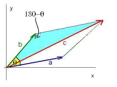

Sorry to disturb, but could we have found the magnitude of the resultant by using the parallelogram law? :confused:
Yes, you can.
The magnitude of the sum of wo vectors ##\vec c= \vec a+\vec b## is
##|c|=\sqrt{ ( \vec a + \vec b)^2}=\sqrt {|a|^2 + |b|^2 + 2|a||b| \cos (θ) }##
which is the length of the "long" diagonal of the parallelogram made by vectors ##\vec a## and ##\vec b##. θ is the angle between the vectors. You can also apply the cosine law for the blue triangle.
ehild
