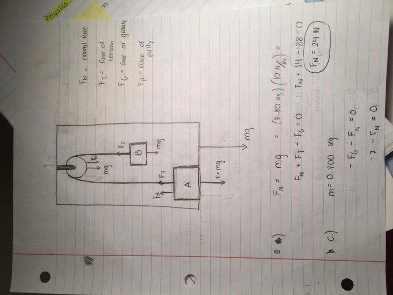

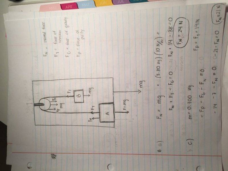

Ok, here is one of my best attempts. I've been working on this problem many times so far. I am really confused how to solve c.), so I left it blank. Could you please give me guidelines now? I would really like to understand this problem, I'm really not trying to get an easy homework pass.
Here is the first page ...
and here is the second page of my work ...
FYI, you can upload more than one image per post, and you can insert them in-line in your post text to make them full size by selecting the FULL IMAGE icon next to the thumbnail when you are creating your post.
It's unfortunate that your images are not oriented properly, but at least your text is clear. The formulas are simple enough that you would probably be better off typing them in so that they are easily quoted and commented on.

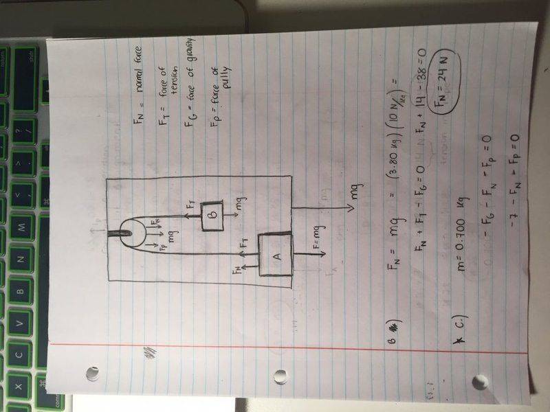

That said, for part (c) you defined a force Fp as "force of pulley". Can you elaborate on what that is?
Sorry, "Force pulley" was a mistake. I erased it from the FBD and from the equation.
Anyways, can we solve the problem now? For the parts I did solve, are the answers correct or close to being correct?
Also, sorry, but I was unable to upload a "portrait oriented" image.
Your answers to parts (a) and (b) are correct.
For part (c), what effect do you think the rope has on the pulley? (I was hoping that the Fp would represent that contribution). What force(s) are transmitted to the pulley by the rope?
Ah, ok, I see what you mean. Perhaps that's what I was originally thinking when I included Fp on my FBD, but after I returned to the problem, I forgot why I put it there in the first place.
Ok, so I re-did my work for part c.), taking into mind the contribution that the rope would transmit to the pulley. Would it be correct to say that Fp = Ft ?
Close. Note that the rope "attaches" to the pulley twice. The tension is the same for both sides.
Ok, that makes sense.
I would multiply the Ft by two in order to account for the tension coming from both sides of the weight, correct?
So, in that case ...
Fp = Ft = 14N * 2 = 28N
which gives ...
-28 - 7 - Fn = 0
-35 - Fn = 0
Fn = 35N (directed down)

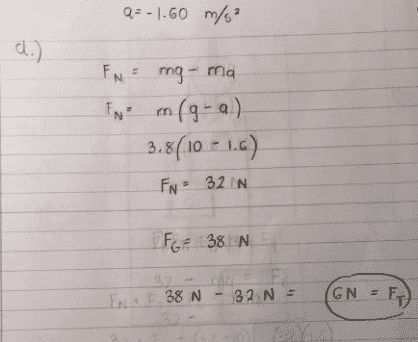

For part (d), in your image for your second page of work (post #9) you showed the following:
What you have calculated here appears to be the change in weight for block A due to the accelerated motion of the elevator rather than the tension in the rope.
Compare this calculation with the method you used for part (a), which also asked for the tension in the rope: Shouldn't mass B play the same role here that it did there?
Ok, so I re-did my calculations with Block B in mind and got the tension of the rope to be 16 N
m(a-g) = - FtB
1.40(-1.6-10) = - FtB
16N = FtBis this correct? would the overall tension be coming just from block B?

You're on the right track but you need to be careful with the signs of the accelerations. The elevator is physically accelerating downwards so it "cancels" some of the effects of the acceleration due to gravity. Imagine for a moment that the elevator were accelerating downwards at g (such as if its lifting cable snapped and it went into free-fall). What would be the apparent weight of block B?
Now in this case the acceleration a is smaller than g but it is still directed downwards. So do you expect the tension in the rope to be larger or smaller than what you calculated in part (a)?
Would the elevator's downward acceleration be negative relative to g, since you mentioned that it "cancels" some of the effects of g?
making the equation
1.4(10-1.6) = Ft
Ft= 12N

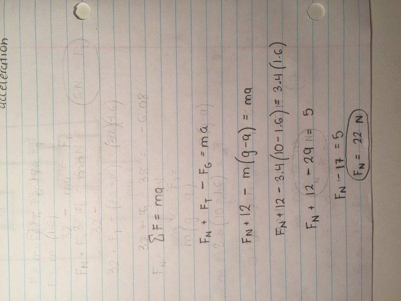

Ok, here's my attempt, hopefully it's correct, or at least close to being correct. I will upload my work as a picture this time ...
You have the mass of block A appearing in two places in your work, with different accelerations. That shouldn't happen as a mass can only have one acceleration in a given direction.

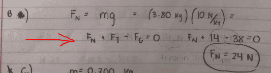

For part (b), on page one of your upload images, you wrote:
Note the indicated line. Since block A is stationary in the chosen frame of reference (the elevator), the sum of the forces acting on it must be zero.
The same applies for part (e) where you are looking for the normal force on the elevator floor: Choosing the elevator as the frame of reference, block A is stationary on the floor, so that the sum of forces must be zero in that frame of reference. You can write the same equation using your effective value of "g".

Unfortunately, my answer for part d.) is incorrect (I checked on my Homework website), which means that my part e.) is incorrect too. What could be the issue? :frown:
You may have rounded your answer too aggressively :smile: You should never round intermediate values in a calculation, only rounding at the end. Keep a few extra decimal places in all intermediate results to prevent rounding/truncation errors from sneaking into your significant figures.

and thank you again for your clear explanation, I re-did my equation, taking into mind that the box is stationary on the floor. Also, I changed my overly-rounded answer to 11.8 N instead of 12 N. Hopefully that works.
Now,
FN + FT - FG = 0
FN + 11.8 - m(g-a) = 0
FN + 11.8 - 3.4(10-1.6) = 0
FN + 11.8 - 28.56 = 0
FN = 16.8 N
Was the mass of block A 3.4 kg or 3.8 kg? I seem to recall it being 3.8 kg.
  • #31
Oh my goodness, you're absolutely right. I used the wrong value for mass. Thank you so much for catching that error. With that changed, my answer is now 20.1 N, which is the correct answer on my homework website!
