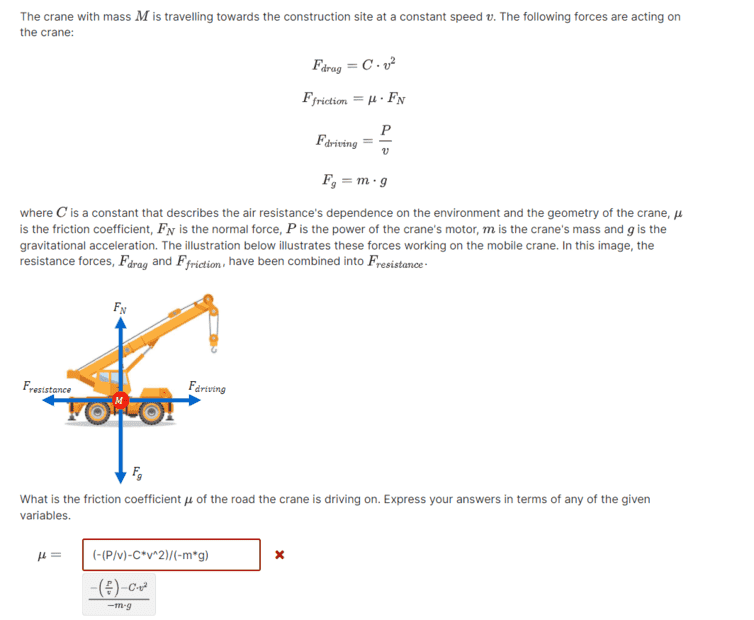

Engineering course top up physics module
See below
Can someone please help me understand where I am going wrong.
I've checked my answer many times and do not understand what I am missing
You probably made an error with signs. Remember that ##F_{resistance} \propto - \vec{e_x}## while ##F_{driving} \propto \vec{e_x}##.
Likes Delta2
answer is apparently
1/(M*g*v)*(P-C*v^3) No idea how this is the case
Likes Delta2
Since ##\vec{F}_{total}.\vec{e}_y = 0##, we have $$\vec{F}_{N} = mg \vec{e}_y$$ $$\vec{F}_{Friction} = - \mu mg \vec{e_x}$$ and $$\vec{F}_{drag} = - C v^2 \vec{e}_x$$ As you did for your answer you then take ##\vec{F}_{total}.\vec{e}_x = 0## adn resolve the equation for ##\mu##.
Likes Thickmax
The crane is moving with constant horizontal velocity. Hence the vector sum of the horizontal forces is zero, that is
$$\vec{F}_{resistance}+\vec{F}_{driving}=\vec{0}$$
In order to transform the above vector equation to an algebraic equation , you have to be careful with signs and conventions. If we make the convention that the positive direction is towards right , then $$\vec{F}_{driving}=\frac{P}{v}\hat x$$ that is it is positive force, but $$\vec{F}_{resistance}=-Cv^2\hat x-\mu mg\hat x$$, that is it is negative (towards the left).
Thus the initial vector equation will transform to the algebraic equation
$$-Cv^2-\mu mg+\frac{P}{v}=0$$ which you can solve for ##\mu## and you will get what you saying at post #3.

Thanks Very much!
But I'm struggling to simplify the last equation still.
-(Cv^2)-(UMG)+(P/v)=0 = -(Cv^2)+(P/V)=UMG
U=(-(Cv^2)+(P/v))/(MG)
Am I missing something?
No you got it right, you just need one last algebraic step: multiply both the numerator and the denominator of the fraction by v and then you 'll get what you say at post #3.

Got it! thanks
But then why does the answer have (1/M*G*V)*(P-C*V^3)
Why can't it just be U=(-(CV^3)+(P))/(MGV) = (P-(CV^3))/(MGV)
Think this is a stupid question as I know the answer will be the same, but I don't understand how to know/why you simplify this far.
It doesn't help that I don't know all the rules either ;)
$$\frac{1}{A}B=\frac{B}{A}$$
