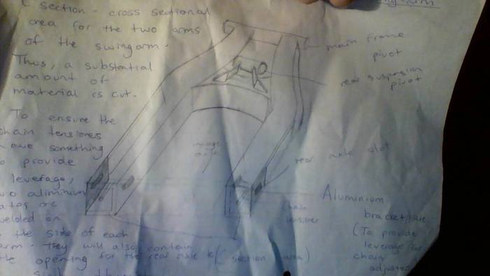

For my final project at university, I am required to design a new swing arm for a Gs500 Motorcycle. I have come up with a C sectional concept when regarding the side beams and will insert X shaped reinforcement throughout the areas of less strength.

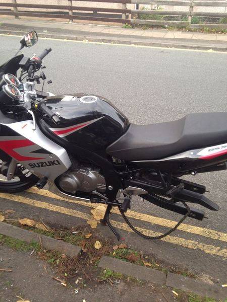

Please post a picture of the complete Gs500 with standard swing arm and a drawing of your proposed modifications to the swing arm .
Hi again,
I have attached below 1picture of my gs500 with the stock swingarm in place. The other picture shows a rough draft of my concept . As you can see, the two arms are made into C sectional beams where a titanium plate with an axle insert will clamp against the end of the arm to hold the axle. I imagine the design as it is will not work in FEA software and thus I will have to add some reinforcement in the c sectional area so I am not sure what the exact design will come out as after.
I just want to get these calculations out the way first so that I can actually see how my model responds to the loads and change it with some sort of solid feedback.

Can you show a mechanical drawing view of the swingarm and rear suspension? You might be able to find one with Google Images, or from an on-line Service Manual.
Where did you get the exact dimensions of the tie points for the swingarm that you are using in your new design?
I attached

I reattached the photos in my last post to clearly show my design and swingarm.

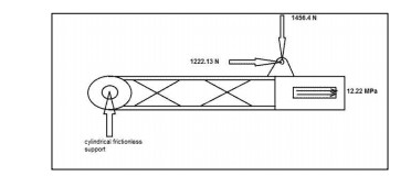

I've had a good look around for a mechanical drawing of my swing arm to no luck unfortunately. One thing I have found is another similar swing arm analysis in which the user, similar to me, has calculated the corresponding x and y forces from the rear shock acting on the pivot point. Attached are the photos of his force calculations.
Then I'm assuming the pressure he's drawn in there on the axle insert is related to the maximum braking/accelerating forces which I have calculated? If that was the case, he must have used an area on which the maximum braking/accelerating force acts upon but I do not know which area to use. Also in the second image, I have dome something similar in calculating the x and y forces of the loads during cornering but this is where I get very confused on how I would input this on to the model in terms of location. Would it be an x and y force acting on the part which joins the two arms or on each arm itself? I'm assuming there would be some sort of lateral imbalance and moment acting somewhere as well?
Going back to his paper, he calculates the horizontal components of the cornering loads as lateral imbalance and the vertical components as torsional imbalance but does not indicate where they are acting exactly. http://inpressco.com/wp-content/uploads/2016/10/Paper61270-274.pdf Here is the paper if anyone can understand what they have done exactly?
