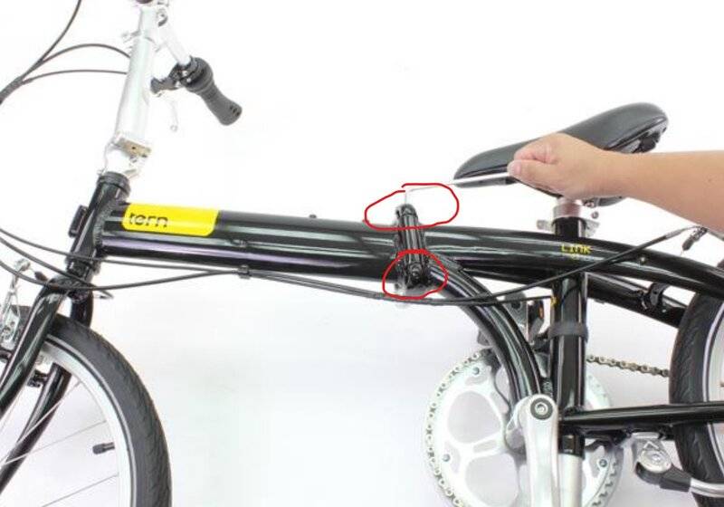

Hi,
I recently bought a folding bike and it turned out over time that its weak point is the main hinge where two bolts (vertically placed) are located.
I've had the lower bolt break twice during a ride, leaving a part of it stuck inside the hinge thread. It's clear that the forces applied were too much for the low-grade steel bolt to handle. Anyway - since I don't want to spend more money on service bolts which are obviously bad quality, I'd like to use ready-made ones but higher steel grade and modify them to my needs by a turner.
My main question is, how can I estimate the maximum forces applied during a ride, for instance when getting off a 10cm curb? I think in these circumstances the hinge is most vulerable to destruction (maybe there are some others?)

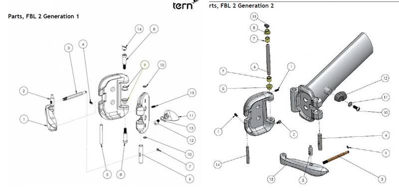

the hinge in this bike is called FBL 2 gen 1, and it has changed over the years to FBL 2 gen 2 so Tern constructors knew wery well that the first generation used to cause troubles. And what's interesting - only the pin/bolt itself has changed. Take a look at the picture below. In the second gen there is only one long pin that goes through the hinge. I also called Tern support and they admitted that 1gen had been faulty.

That is one of the factors that make version 2 superior to 1, the increased diameter of the solid pin.
Could you find a kit to convert yours to version 2?

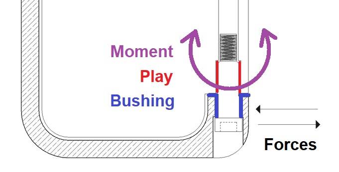

But let me ask You one more thing - I realized that the thread of the bolt could be longer, there is still some space in the hinge between these two bolts. Does the length of the threaded part of the bolt matter in this case? If this part is longer, will the screw be more durable? (I personally don't think so).
I'm asking because I found a ready-made bolt which is almost the same as the original one, but the threaded part is not 12mm but 10. So now I'm wondering if I should convert a longer one, or use the one below.

I don't think converting to 2gen is possible 'just like that'. It was made in the factory as a new hinge version, and while they look the same, in the 2nd gen there's no thread in the hinge (I assume) since there's one long pin used.

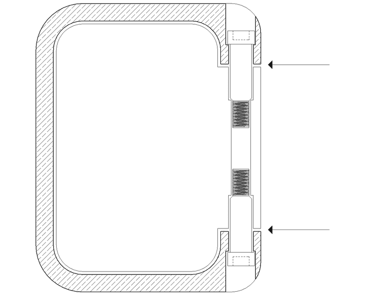

I could use a smiliar solution - make a one long solid rod/pin to fit tightly across the hole in the threaded part of the hinge and thread both ends of the pin to screw in the nuts. It's just an idea that came to mind right now. edit: - nope. I won't be able to fit the socket on the nut to lock it.
I also made a rough sketch of the cross-section of the hinge and slid bolts. That should give You a proper idea of what the hinge looks like. What I didn't realize before, and I know now, is the fact that the shearing force is applied where the thicker cylindrical/not threaded part of the bolt is (and thats understandable and sounds logical). However, the bolts were cut in the place where the cylindrical section meets the threaded part, but that has been said already.

heh, thanks. I know the calculation is rough and not so precise. But that frame support might be an important factor in reducing the stress on the hinge. And for sure, I'd not be able to calculate it more precisely by myself.
But if, let's say, I use a 12.9 grade m8 cylindrical solid pin, that has 50,25mm2 cross-section, its yield resistance
would be..1200mpa x 90%, say 1080mpa x 50,25mm2 = ~ 5400kg.
Significantly less than the previously calculated max force.
Can someone try to roughly estimate by how much such a frame support from the bottom can reduce the strees force on the hinge?
