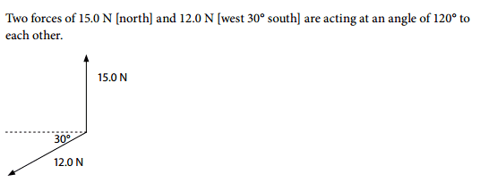

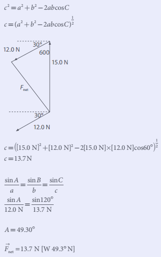

The lesson that I am doing provides a similar question and answer, i tried to follow it for the question that I am answering, but i don't know where i went wrong. Here is the question from the lesson. Could you explain how i should answer my question using the qts below as a guideline. I undestand what you mean by the x and y plane, however the lesson wants me to follow this method:
i need to know how to use this same method to answer my question. please help

I suspect that you misunderstand how 60 degrees was arrived at in the worked example. It was not by adding 30 and 30.

Look at the diagram. The 38N force points down and to the right. Above it there is a dashed line. What is the angle between the 38N force and the dashed line?
What is the angle between the dashed line and the 32N vector?
Likes CAT 2
the angle between the 38N force and the dashed line is 35 degrees
the angle between the dashed line and the 32N vector is 90 degrees

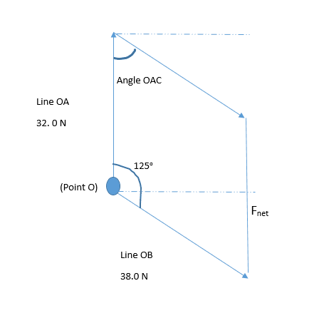

is this what you mean. Line OA and OB represent the two forces acting at point O. is this what you mean by a parallelogram. I don't know how to solve for angle OAC
Yes, that's the right diagram.
You have a straight line OA meeting two parallel lines OB, AC. The relationship between angles AOB, OAC is very basic geometry.
Likes CAT 2
im still not getting it, how would i solve for OAC?
does it have anything to do with using these equations:
and once i solve for OAC would that give me the angle I am supposed to use to solve for the resultant
wait would angle OAC be 55 degrees
90-35 = 55

The angle OAC is obviously the same as OBC. The line OB is the hypotenuse of a right angled triangle involving the dashed line. Your original 35 degrees is an angle of that triangle. So what is angle OBC?

  • #34
@haruspex
This was the previous diagram i had made, it forms a triangle instead of a parallelogram. I labelled angle A .
SinA / 38.0 N = Sin55° /32.9 N
