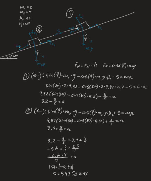

Two bodies (masses 2 kg and 4 kg) are joined by a wire. The system is laid along a rough inclined plane (the angle of inclination is 30 degrees). For the upper, lighter body, the coefficient of friction is 0.2 and for the lower it is 0.12. what is the thread force after the system is left to itself?
F=ma, F=mg, cos, sin,

Here is my attempt at a solution for the problem stated above:
Where m1 and m2 are the masses
Where Ff1 and Ff2 are friction for each mass
Where a1 and a2 is the resulting acceleration
Where S is the fore of the wire (threadforce)
Where FN is the normal force
The answear should be 0.91 Newton
Any clues on what I need to change?
Thanks on beforehand for your help!
There are two possibilities that I can see.
  1. The two masses accelerate with the wire under tension (thread force) they must the same acceleration because the wire is assumed inextensible. This means that the velocity of one block does not change relative to the velocity of the other.
  2. The trailing mass is accelerating faster than the leading mass in which case the tension is zero.
You need to determine which possibility is the case here and then write the appropriate equations. Specifically, if (1) is the case, you must use ##a_1=a_2=a## in the equations.

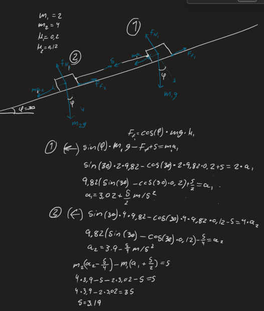

Here is my new solution to the problem (with the correct answear!)
Thanks for you help and time!
If you had solved the problem symbolically to find an algebraic expression in the form ##s =\dots~##, you would have avoided round off errors and your answer would have been closer to the given one. Anyway, good job!
