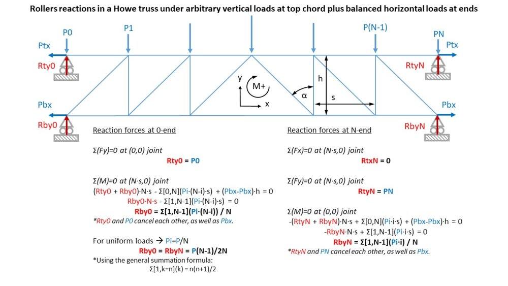

Back to the problem, I have to say that it was possible to solve the truss with just 4 rollers as boundary conditions. First, as you recommended, I included the horizontal loads up front with the vertical loads. Then, I enforced that all horizontal loads are self-cancelled in the problem definition (this is what I meant when I said "Horizontal loads would be applied symmetrically at both ends"). This way, the system becomes statically determinate, even without pins, since I was able to obtain all forces using just the joints and sections methods. I will not trust the general indeterminacy formulas anymore :-). I've successfully validated this approach in Mecway.

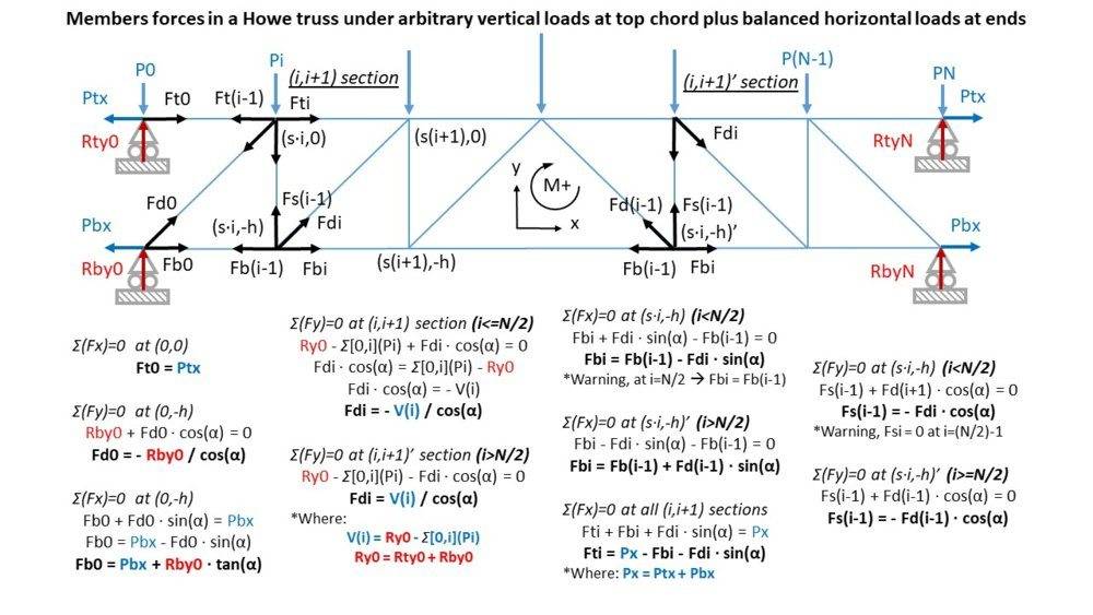

I want to share with you and the community the formulas to obtain all the forces in a Howe truss supported by 4 rollers and under arbitrary vertical loads at top chord plus balanced horizontal loads at the ends, they are summarised in the next two figures (Figures 2 and 3):

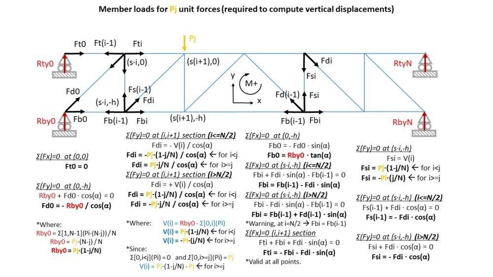

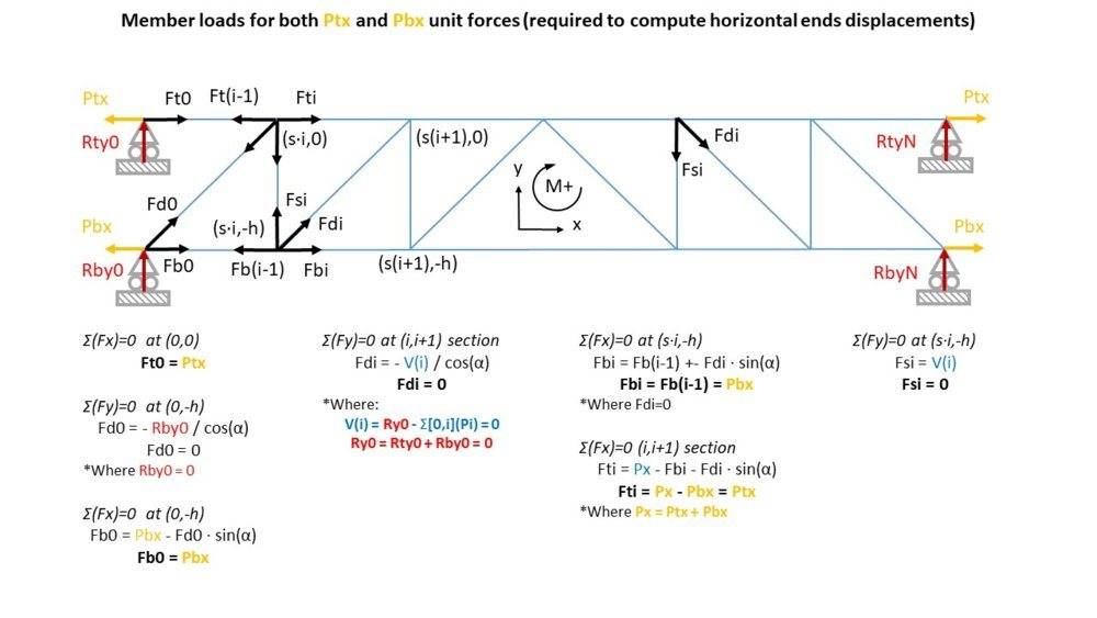

In addition, I used the unit force method to predict the displacements at both ends (top and bottom chords) and at any arbitrary top chord joint. The formulas to obtain the members forces caused by such unitary loads are shown here (Figures 4 and 5):
Using these formulas with the displacements of the compatibility equations (now a 2x2 matrix), it is also possible to obtain the forces required to convert the truss ends from rollers to pins, i.e. to compute the Ptx and Pbx forces that lead to zero displacement upon loading. This will help me to determine the optimal boundary conditions, i.e. those that lead to the lowest weight.
Now, as part of the optimisation process, I want to use the minimal cross-section area for each member. Is it as simple as using the material strength (##\sigma##) and each member forces (##F_i##) to obtain the corresponding areas (##A_i##) as well as performing the Euler buckling checks just in compression members?
$$A_i=F_i/\sigma$$
Please, let me know if you see mistakes in my formulas or drawings, and thanks again for your kind help!
Oh sure I missed that symmetry of horizontal loading so it’s ok to release all 4 horizontal reactions in this case, but bear in mind that this is still an unstable truss because any differential horizontal load will send this truss rolling to neverland. But it’s fine in this case since your actual truss will be all pinned at the supports.
I’m old school so I don’t know much about optimization programs, maybe Mathlab? Or check out those spaghetti trusses students create to hold a certain weight. I mostly rely on our forefathers 100 years ago and more who were geniuses without any computer aid and I follow their designs. It’s a trial and error process where the idea is to come up with the best truss height and number of bays and truss type to keep the bottom chord at a minimal stress with the least midpoint deflection and the lightest overall truss weight, but you’ve got to consider fabrication cost and the labor cost of building the truss, you might have lighter members but more of them in a rather labor intensive construction installation. Watch for buckling also bad compression members may have to be braced laterally in both directions to minimize l/r ratios.
