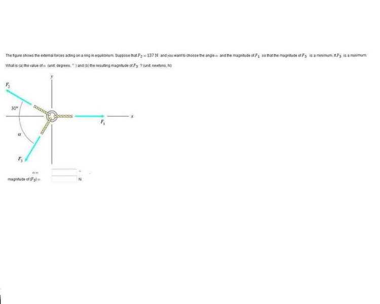

Hey guys, I am stuck on this question. It is first year engineering vector statics. Here it is.
Thanks for any help!
Hi Oblivion77! :smile:
Show us what you've tried, and where you're stuck, and then we'll know how to help. :smile:
Well, i resolved the vectors into the components and added the sums and equaled them to zero (since its in equilibrium)
[tex] \Sigma Fx = -118.65 -F3Cos[\alpha] + F1 =0[/tex]
[tex] \Sigma Fy = 68.5 - F3Sin[\alpha] = 0 [/tex]
I don't know how to go from here, with the "minimum"
Yes, that's right. :smile:
Tip: when you have two equations with cos and sin,
put the cos and sin on their own on the left, then square and add (using cos2 + sin2 = 1, of course) :wink:
That will give you F3 in terms of F1, and then … ? :smile:
...after you solve a little bit, you get;
137/2=F3*Sin(a)
so for a=>90 degrees sin is max and F3 is min.
Min F3 is 137/2...And a is 90 degrees...
and magnitude of F1 is;
F1=Cos30*137

MrEnergy said:
137/2=F3*Sin(a)
F1=Cos30*137
oops! I over-complicated it! :redface:
Yes, you're absolutely right. :smile:
