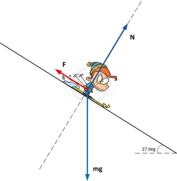

I have a free body diagram drawn in front of me. I don't know if there is a way for me to post a picture of it on here thhough
It is possible to scan a picture then upload it to PF using the "manage attachments" dialog.
Usually you can describe it - put the +x axis pointing down along the slope and the +y axis pointing up, perpendicular to the slope.
The forces are gravity and friction with a normal force from the slope along with an applied force 45deg to the slope provided by the skier. All forces need to be resolved into x and y components. Remember that the friction force is proportional to how hard the skis press into the slope.
Ten you can tell me what the forces are in each direction - use symbols rather than numbers: it is best practice to leave the number stuff to last.
note: sin(45)=cos(45)=1/√2
This was given to use by our teacher to help us with this last problem:
Maintain Downhill F = Downhill F (comp. wgt + comp. F poles) – Wind – Friction (uD * (comp. wgt – comp. F poles))
The X's in the equation that I posted in post two represent the component F of the poles. I have a free body diagram drawn with a right triangle, but all I have in the triangle at this point is the angle. I can't figure out what goes in the opposite side of the triangle. I am guessing it is the normal force of the skiier (765.18N)

Anyway, can I help you guys with a picture from my old album ? Very dusty. I already drew in what I think you know anyway. My mg is and has been a little more than 78 kg x g, so I left in the expression instead of writing 1000. So much more meaningful too. The others I left a little vague on purpose. But I did merge two already.
BvU has provided a starting point.
If the red F is the applied force from the poles, you need to ask if it is in the right direction.
He also forgot the friction force.
I gave you a list of forces to go on the diagram in my last post and suggestions for how to go about getting the components. Please follow suggestions.

So friction and wind were supposed to go in the red arrow. I was still in a) and b) without realizing the numbers he gave under attempt: were the right solutions. Cougar was in the 45° pole stuff already. In the next picture in my album I use the poles too ...;-)
Oh I think I left out the wind force in my list.
