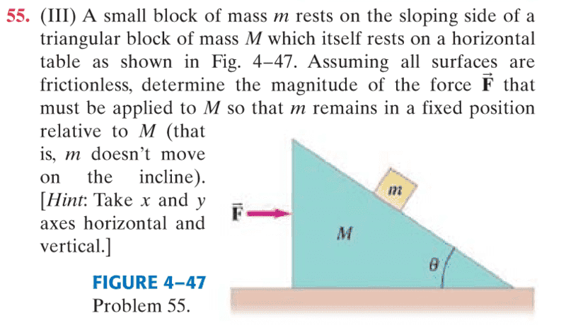

Forces on the slope of a triangular block

I uploaded the question as an attached file.
Fz = mg , F = ma ,
The slope : x
Perpendicular to the slope: y
I thought the Y forces can be neglected because the normal force counters the y component of the gravitational force.
Fz,x = mg sinθ
Without an external force, Fz,x is the only force along the x-axis. So the acceleration a=F/m. This acceleration must be equal to the acceleration of the big block, so F=Ma = (mgsinθ)/m * M = Mgsinθ.
This seems logical to me but the answer book states a totally different answer: (m+M)gtanθ.
What did I do wrong?
Thanks in advance!

What we require here is for the acceleration of the block down the incline plane to be equal to the acceleration of the system along the plane:
##a\cos(\theta)=g\sin(\theta)##
Now, use Newton's 2nd law of motion to rewrite ##a##, and solve for ##\vec{F}##.
The acceleration of the block has a component in the y direction, so the y direction forces contribute to it.
caspeerrr said:
The slope : x
The hint said to use vertical and horizontal axes.
