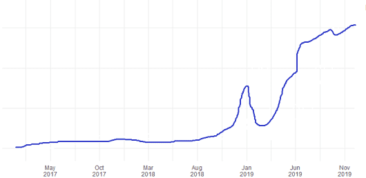

(2) The number of customers who used their customerId in the app for the last 2 yearsThe first thing I thought I should do is just use simple linear regression on (2) for the forecast. Here is a rough representation of what that data looks like:

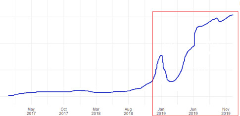

Firstly, if I was going to do a trend line here, would it be the right thing to do to just look at the data from around Jan of this year onwards where there is an obvious increase that aligns with the new features added to the app about a year ago (the red box below)?

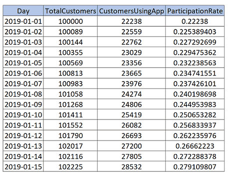

Then I thought about another way to do this which is to for each date, determine the total number of customers for each date (a rolling number) and the number of customers using their Id in the app on each date (rolling) so I could determine the number of customers using the app with their customerId as a percentage of total patients (called Participation Rate). A dummy dataset is as follows:
With this dataset I would do regression on the number of Total Customers and predict that in 12 months and do regression on the participation rate to predict that in 12 months and then simply multiply the two forecasted numbers together. Is this a sound approach? If not is there a better way to achieve this?

In your case you have a series that is significantly increasing over time, so doing something like differencing can help stabilize that jump to make better predictions.
