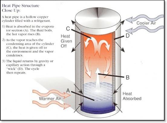

But what if I have a closed glass container with a cool top and a slightly warmer base. I start with water covering the base and pull a partial vacuum. Bubbles of steam will then form on nucleation sites near the top of the warm liquid, (where the hydrostatic pressure is least), the steam released from the bubbles will rise to the cool top surface where it will condense and drip back down to the pool below. That should be a continuous process so long as I supply sufficient energy to maintain the temperature difference.

Yes, and this is actually a very, very good way of transferring heat from the hot side to the cool side, since the amount of energy to boil a liquid is quite large. This is how heatpipes and vapor chambers work, both of which are commonly used in electronic devices to transfer heat from high power integrated circuits (like CPUs and graphics cores) to heatsinks where the heat can be dissipated by a fan.

Yes, you can, given hot and cold reservoir (sink) exist forever. Heat is a boundary phenomena. There should be a enough temperature difference to encourage perpetual cyclic change of phase, although possibility of changing phase happens also in an isotherm, but not that much compared to sensible heat.
Above photo is a heat pipe, which partially evacuated and filled with a volatile media.
