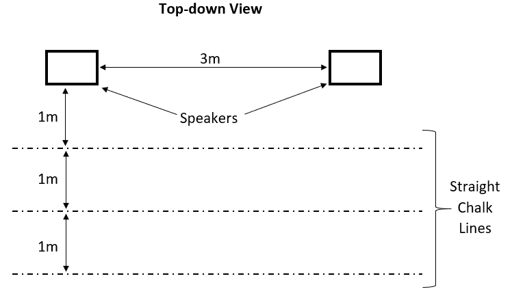

We performed an experiment where 2 speakers were set up with 3 chalk lines spaced 1 metre apart from each other in front of the speakers. A 500 hz and then a 1000 hz sound was played through both speakers. We were to walk along the lines and mark the position of where the sound was the quietest (node) for both frequencies. After that we had to measure the distance between these nodes and calculate the wavelength.
For theoretical wavelength: lambda=340m/s divided by frequency
For experimental wavelength I used: lambda=2*distance between nodes
The values calculated was nowhere near the theoretical values, though I guessed they won't be as the results recorded was incredibly inaccurate. My teacher acknowledged the fact the final values won't be close to the theoretical ones but also said that my formula was wrong, that it works to find wavelength of the first line and not the other 2. I need help finding what formula to use, I have searched everyone but I don't really know what I'm looking for and our teacher said that it's not in the textbook that we use.
Here is a diagram of experiment:
Here is the results:

As seen above the wavelengths are not same for the different lines, that's because I used the same formula. My guess is that there should be a third value in the equation, eg 'n' where n might equal number of lines/harmonics or whatever. But I'm not sure.
Any help would be appreciated relating to the formula. I need the formula of lambda when the waves are in the same direction.

That's not what D means in the formula you quote. For interference, what is the relevant distance?

Why does interference occur?

Yes, but what is happening at a static node? Why is it always destructive at that point? Think about phase.

If you draw a graph y=sin(x) then shift it sideways a bit you are changing its phase. E.g. it becomes y=sin(x+φ), φ being the phase shift.
If the distance from a source to a listener is not a whole number of wavelengths then, at a given instant, the listener is receiving the signal at a different phase from that at which it is being emitted.
If a signal from one source can take two paths to a listener, and the difference in the path lengths is not a whole number of wavelengths then the listener receives the signal at two different phases. This will cause the signal to be partly or wholly cancelled. That is interference. If mostly canceled then destructive interference; if in phase or nearly so then constructive interference.
In the present case you have two loudspeakers, but you can assume they emit in phase, so effectively a single source, but with different path lengths to the listener.

Suppose that at some instant the waves generated from one source have displacement (pressure, say) A sin(kx) at any point which is distance x from that source. You can visualise this as waves forming concentric rings around the source, yes?
If the wavelength is λ then points at distances x and x+λ have the same phase at any given instant. (They won't have quite the same displacement since the waves get a bit smaller as we get further from the source.)
So sin(kx)=sin(k(x+λ)), whence kx+2π=k(x+λ), 2π=kλ, k=2π/λ. So we have displacement A sin(2πx/λ) at the point.
Now consider the same point in relation to the other source. If its distance from that source is x', what is the displacement of the wave from this second source at the point? What do the two displacements add up to?
