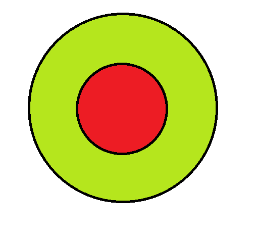

2*PI *radius *radius won't come in the formula because the cylinder given is not "packed" from top and bottom.
You need to subtract inner area and outer area.
You need only the area of green part, The red part is not required.

We need to calculate the the green area(see the picture in my previous post) for the top and the bottom of the cylinder.

Buffu's drawing in post #3 shows the end of the pipe. You need to calculate the area in green, not both areas (green and red). The outer radius of the pipe is 4 ft. and the inner radius is 3 ft. There are two ends to the pipe that must be included in the total surface area.

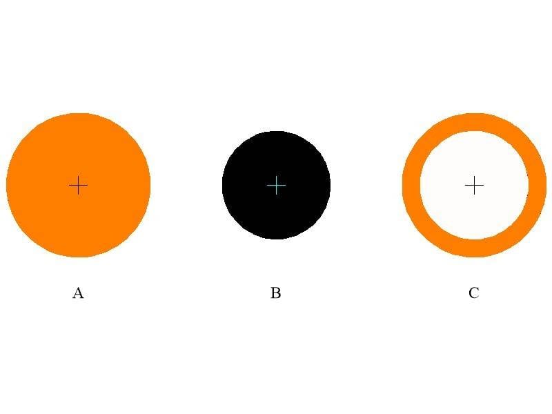

The ends are NOT circular!
The ends look like C in the image that Nidum posted.
Sorry. Picture C is an orange circle.
Zulfi.
No it is not. A and B are disks. C is an annulus (a ring). What is the area of an annulus?
