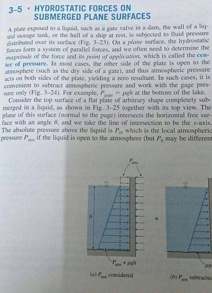

In summary, the equation for finding the y-coordinate of the centroid (yc) is defined as 1/A multiplied by the integral of y with respect to A. Therefore, at 3-20, the equation for the moment of inertia (P0) multiplied by the integral of y with respect to A will result in P0 times Ay, not P0 times yc2.
werson tan
183

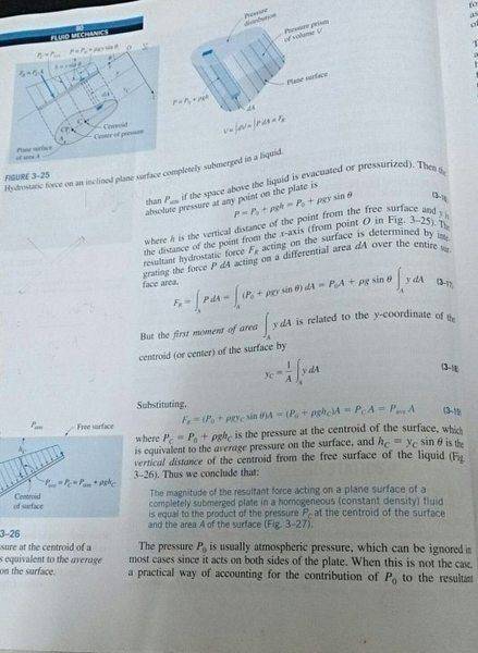

why the y ſ P dA will equal to P yc A ? why not P (yc^2) A ? since yc = ſ y dA / A

It comes from the definition of yc at 3-18.
according to 3-18 , i would get P (yc^2) A instead of P (yc) A ... am i correct ?
No.
3-18 defines ##y_c=\frac 1A\int_AydA##. So at 3-20, ##P_0\int_AydA=P_0Ay_c##.
How do you get yc2 terms?
