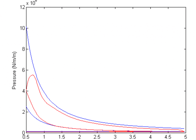

Hi! I am a new member to this great Forum! I am so excited to be a part of this wonderful community. Anyway, as the title suggests, I am looking for a way to calculate the pressure in each cylinder of any Four Stroke Engine at any given crank angle of Cylinder One. I have been trying creating a spreadsheet based on a very interesting PDF document I found a couple of weeks ago. One cylinder is fine, but trying to make the formulas for cylinder pressure for each cylinder flexible to change/adapt to the change in degrees per cylinder is getting to be really frustrating. Does anyone know a whole, single function out there for cylinder pressure?
Thanks ~ Jason Louison.

Based on the crank angle alone, no, there is not an equation for pressure. There are many more variables involved beginning with if there is a piston offset or not.

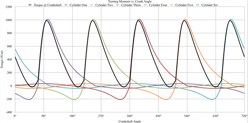

Thanks, Removed Unnecessary Data Tables, But I think The Turning Moment Diagram is off.

Assume the forcing profile is the same then just phase each cylinder according to firing order.

My first thoughts also but I don't think that's what he is asking. I think the question is; When cylinder 1 is calculated for pressure at a given crank angle is there an equation that will concurrently give the pressure at the remaining cylinders at that same moment. It's why I brought up offset pistons because then the stroke timing is an additional variable to factor in. Typically offset results in a longer power stroke in terms of time but the velocity of the piston is not linear so it's different at every cylinder at any given single moment. Equations for time are not the same as those for angle. The equation would need to include conversions of variables. From there cylinder head valve timing and air flow and air pressures have to be factored in at every crank angle in relation to the number 1 cylinder in the OP's example. How precise is the equation going to be depends on how far the inclusion of variables is going to go. If there is a single equation for this that covers all engines it's one I've never seen or heard of. I'm not even sure if this is possible to determine from mapping performance through the typical ECU. Not that it wasn't possible. It was a matter of decisions about what needed to be recorded for the family car. Tuner chips even recorded at predetermined crank angles for specific engines and not continuously for the entire 720 degrees of a complete cycle.

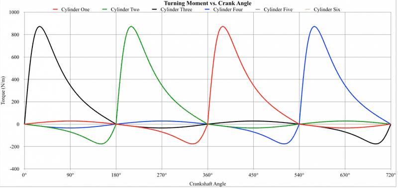

Some of the graphs I have made so far!

I think you misinterpreted what he wanted to do. It's pretty clear that he had a single cylinder model he was happy with and just wanted to phase the calculation. This is what he has done by the conditional statements. By universal engine he meant 1,2,4,6,8,12 cylinder etc.
OP your model is effectively turning the PV diagram of the cycle into a torque vs crank angle. Are you going to consider inertia effects and friction?
EDIT: Or have you, I can't tell if inertia is already in there from the graphs. : /
Likes Work Hard Play Hard
Yes, there are Inertia Contribution columns in the data tables for each cylinder. The Pressure-Volume diagrams have not been implemented yet, but will be soon :)
Is this a run moving 'quasi-statically' then? As that torque profile looks like it's only based on cylinder pressure.

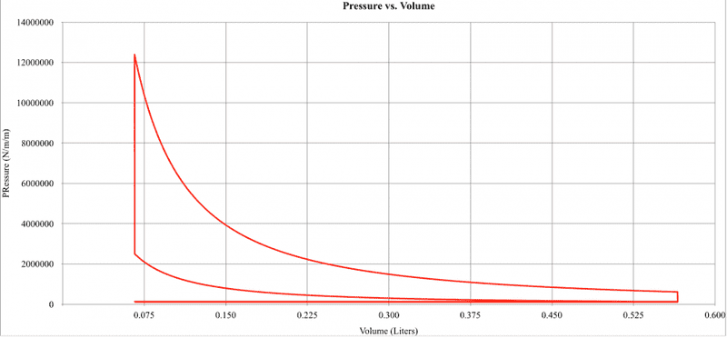

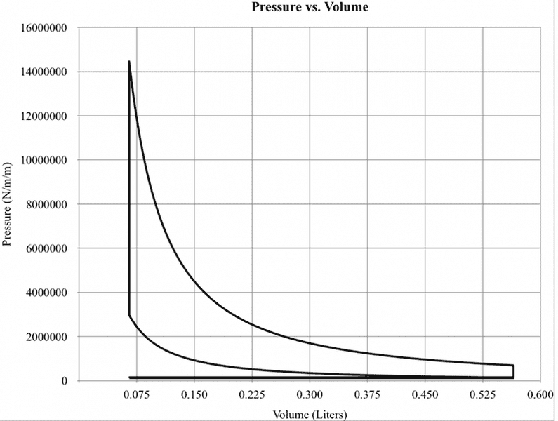

The question now is how do I distort that p-V diagram given peak torque rpm's and current rpm's...
May need to start a new thread. : /
It makes sense to keep it in this thread, as it's a natural progression. Distorting the p-V diagram is where things get 'wooly', and this is where Work Hard Play Hard's comment about not having a single formula is oh so true. There isn't really any way to calculate it by hand.
However, there are some broad assumptions we can make that moves the model closer to reality. For each stage of the process we can introduce assumptions that cause losses. You may want to start by reading the finalpaper.pdf again with the assumptions they make.
eg. Ideal otto assumes isochoric combustion (ie instant prssure raise). - We know this isn't true in reality, the burn begins bTDC and peaks aTDC.

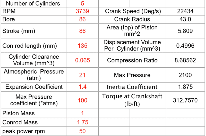

Here is just a little dummy engine I made: A turbocharged 2.5 Liter Inline Five-Cylinder Engine.

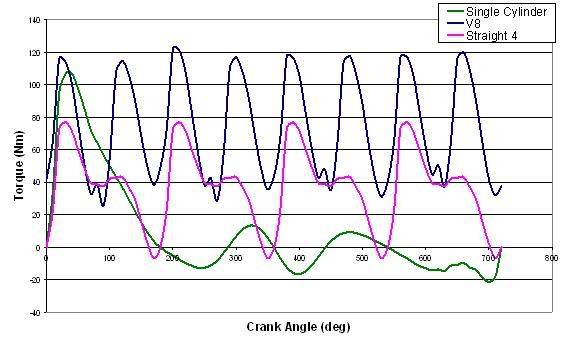

Maybe Chris can help you with this since I believe this graph is his. What is going on in every other trough in the V8? Why the little skip with this pattern? Jason, how does this torque curve compare to yours?
Chris, have you ever seen a simulation that actually factored in or out, the flywheel? Or further yet, factoring for engine balances? I'm thinking of:

Not quite :( If I set the Cylinder Pressure not to be darn huge maybe I could get some great results like this one. This is a single cylinder engine in my diagram.
So I just need to tweak some parameters and I should be good. As for the "dummy" engine, your absolutely right, so I will now do an engine very close to me: The TOYOTA 2JZ-GTE. (Its even in my profile pic!)

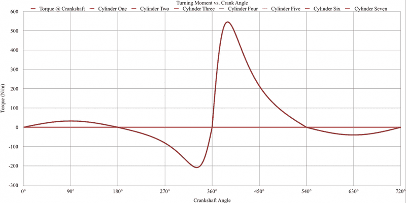

OP your turning moment is based on cylinder pressure only. The extra 'hump' are caused by the reciprocating inertia of the piston & conrod.
Imagine you hooked the crank up to an electric motor. No firing. You'd get torsional forcing on the crank due to the accelerations of the piston mass.

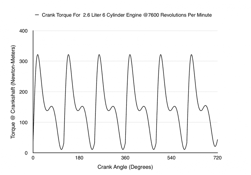

Wow. Turns Out the Formulas I have been using this whole time were wrong. Following this, the spreadsheet has had a series of successful updates! :)
Graphs are now more realistic!

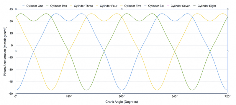

More realistic, but not quite right yet. Do that same engine at a few different speeds.
Before you actually do it cosider the following:
What should happen to mean piston speeds?
What would this do to piston acceleration, hence forcing?
What would you expect to see to the torque cyclic graph?

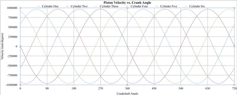

  • #31

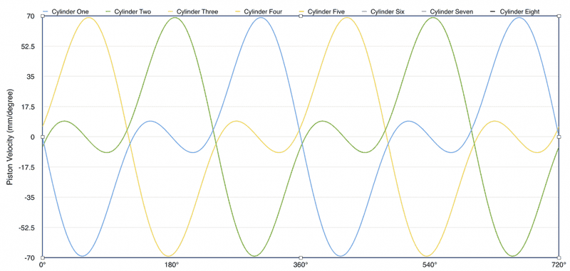

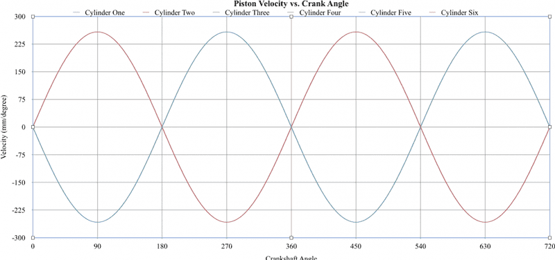

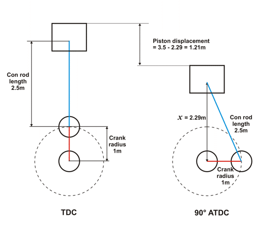

Is your piston acceleration and velocity relative to crank angle shown as being sinusoidal on that graph?
Piston Displacement = √((con rod length)*2 + (crank radius)*2 - 2lrcos(con rod angle))
  • #32

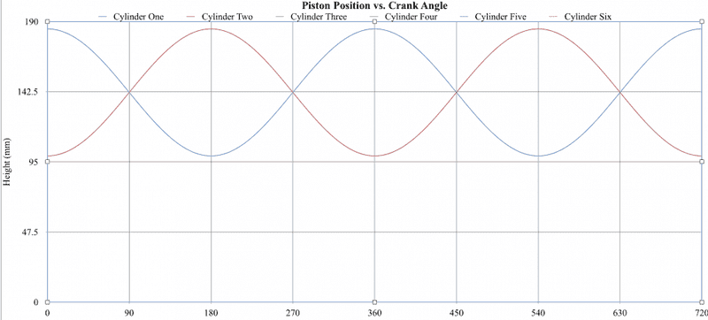

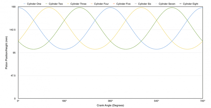

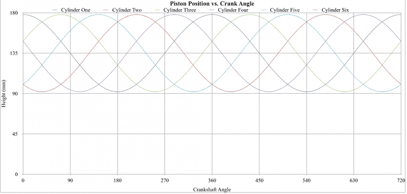

Hi guys, I have been doing updates to the spreadsheet all day, so I remember very little about the specs of that engine. However, if its piston position, velocity, and acceleration you want to look at, here are a few graphs all for the same engine. all data logged on the graphs are taken at 3000 Revolutions Per Minute.
Engine: TOYOTA 2JZ-GTE
Specifications
Engine Type: Inline Six Cylinder Engine
Valve-train: DOHC w/wo VVT-i
Aspiration: Sequential Twin Turbochargers
Bore: 86 mm
Stroke: 86 mm
Connecting Rod Length: 135mm-145mm (145mm used in graphs)
Compression Ratio: 8.5:1
*Note: If the graphs do not display all of the cylinders in the engine, it is probably because they are at the same position/velocity/acceleration as the one/all of the cylinders.
Ex: Inline Six
720÷6=120
120*3=360, Cylinder Four is at the same position as Cylinder One, Because it's crank angle is spaced one revolution after cylinder one. I don't know how to solve this

Cylinder 4 wouldn't be the same as cylinder 1 though in an I6. Look at an animation of an I6, the cylinders should be phased according to firing order. 153624.
Cyl1=Cyl6
Cyl2=Cyl5
Cyl3=Cyl4
Likes Jason Louison
