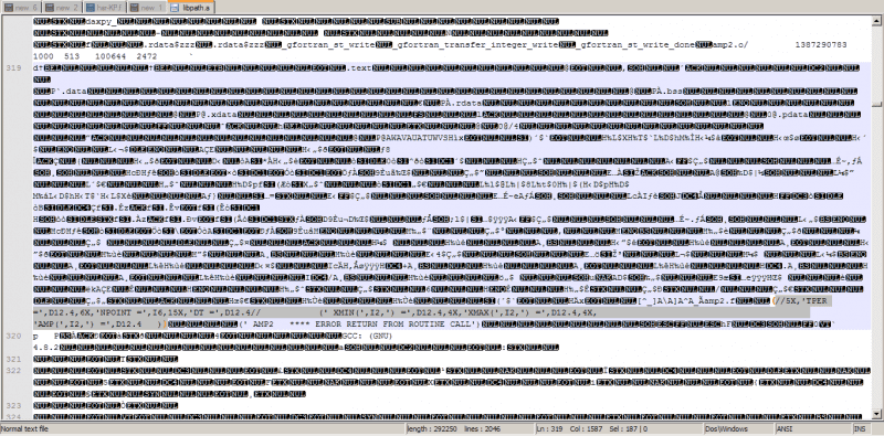

Hi,
I am having a bit of trouble trying to record the output from my code and any help is highly appreciated.
Attached is the code that needs to be looked into (changed extension to .txt from .f as PF wouldn't allow it) and a screenshot of output that I am trying to record.
What I am trying to do is collate the XMIN (1), XMIN(5) and XMIN(9) together with C(1) output. Similarly, I need to do the same with XMAX and AMP outputs.
I tried adding the FORMAT and WRITE statements towards the relevant section (now commented out) to do the needful, however there is still no record of it in any of the files propeq.dat, propeq.dat1 and integrate.csv as asked by Fortran to open when running the code.
Please assist me.
Thank you for taking your time!

Based on the suggestions, I modified the code such that the output is written in a new file called xmin.dat
So, I modified the code as
Code:
      OPEN(1,file='propeq.dat')
      OPEN(2,file='propeq.dat1')
      OPEN(3,file='integrate.csv')
      OPEN(4,file='xmin.dat')
The governing code for the output shown in the picture is has been modified as:
Code:
  11  FORMAT(E16.8,',',E16.8,',',E16.8)
      JOB    = 2
      JBIF   = 0
      NSTEP  = 20
      CALL PATH (FCN,JAC,N,IJAC,X,TPER,NP,INP,TP,TQ,LAMDA,
     *           JCASE,JOB,JBIF,ILAM,IER,W,IW)
      WRITE(4,11) C(1),XMIN(1),XMIN(5)
However, that gives the output in xmin.dat as:
Code:
  0.63781250E+02,  0.00000000E+00,  0.00000000E+00
It should have had varying C values for the first column and the equivalent XMIN(1) and XMIN(5) values. However, that is not the case?

I'm looking only at the code you show above. In this code, the write statement executes once, printing c(1), xmin(1), and xmin(5). None of the lines above it that you show here modifies these arrays. If you expect different output, please show more of your code, especially whatever parts modify these arrays.

The code below
Code:
JOB    = 2
      JBIF   = 0
      NSTEP  = 20
Gives the output (mentioned only the first 3 entries as PF wouldn't allow me to add all 20 entries:

@Mark44
I believe that you are trying to find the mention in the code regarding XMIN, XMAX and AMP. There isn't. The code is calling the library to give that output. I searched the library for the mention of xmin, xmax and amp and it points to a file called libpath.a
I have attached the image showing that.
adishpatel said:
@Mark44
My question was about the arrays XMIN, XMAX, and C, the variables you mentioned at the bottom of post #4, which I've copied here.
Here is the code (below) that you showed in post #4. My issue is that the call to the PATH subroutine doesn't have any of the three arrays you asked about as parameters, so my question is why you would think that this code has anything to do with XMIN, XMAX, and C? If the call to PATH somehow causes changes to XMIN, XMAX, and C, it must be either that these variables are COMMON blocks or that one or more of the formal parameters to PATH are structures that have XMIN, XMAX, and C as members. If there are any other possibilities, I can't think what they might be.
What I wanted you to do was to show me the code that changes XMIN, XMAX, and C, without me having to dig through and find it myself.

SteamKing said:
If you don't have a text editor handy, opening these .txt files in MS Wordpad displays the original formatting as Fortran source code. :wink:
Good to know. In Notepad, none of the original formatting shows up.
@Mark44
I tried looking for the DO loop but haven't been able to find what it yet. What I did instead was modify the code this way to somehow control NSTEP:
Code:
   11 FORMAT('C(1)=',D20.10,' XMIN(1)=',D20.10,' XMIN(5)=',D20.10)
      DO 111, NSTEP = 1,5
C Path call for bifurcation points.
      JOB    = 2
      JBIF   = 0
       WRITE(4, 11) C(1), XMIN(1), XMIN(5)
  111 CONTINUE
However, this changed the entire ouptut and also kept on running in some sort loop which it shouldn't have.
Anyhow, at the end of it, I have been given the following output:
Code:
C(1)=    0.6300070711D+02 XMIN(1)=    0.0000000000D+00 XMIN(5)=    0.0000000000D+00
C(1)=    0.6300245710D+02 XMIN(1)=    0.0000000000D+00 XMIN(5)=    0.0000000000D+00
C(1)=    0.6301464454D+02 XMIN(1)=    0.0000000000D+00 XMIN(5)=    0.0000000000D+00
C(1)=    0.6314081577D+02 XMIN(1)=    0.0000000000D+00 XMIN(5)=    0.0000000000D+00
C(1)=    0.6339081450D+02 XMIN(1)=    0.0000000000D+00 XMIN(5)=    0.0000000000D+00
I compared the C(1) values to the normal output and they do not correspond. And the output of XMIN(1) and XMIN(5) shouldn't be 0 either.I believe in order to achieve what I am trying to do, we need one controlled array? However, can we simply record all the data ranging from NSTEP 1 to NSTEP 20 (for example) and then run a second code which managed to rewrite the data as required in another file?
Would you want me to upload the files in a different format that is acceptable by PF as .f files aren't attachable?
No, txt format is fine. I was able to view them using WordPad.
I'm not sure what the history of your project is, but from what I see it looks like you have cobbled together a program with a large number of source code files. By "cobbled up" I mean that I don't see much evidence of planning or organization to this code, which makes it extremely difficult to modify or debug. The best advice I can think of is for you to analyze the code to get a high-level overview of this program. Your main program (the routine marked PROGRAM) should capture these high-level steps.
You said that you had used a debugger when you were first writing this code. I would advise you to be using it heavily to get a better understanding of what your code is doing.
