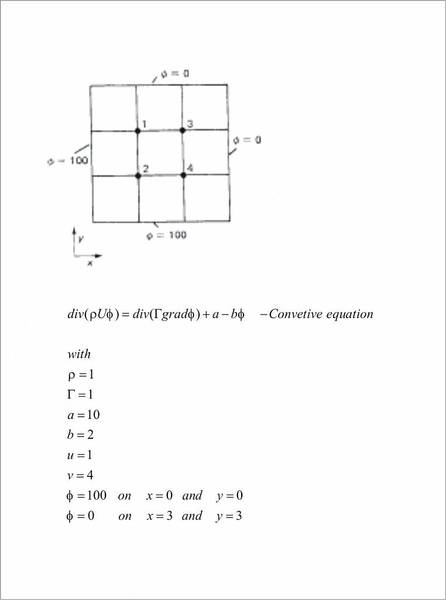

i need to know if someowne can help me with a program that i have to do to resolve a heat problem of the Patankat(autor) book. exercise 5.1 is the problem and to solve it i need to use the upwind method and the CDS method..
please help
thanks

i have to do a program in fortran to resolve this problem.
it´s a problrm of convective heat transfer, bi-dimensional with generation of heat on a uniform meshgrid. if you know, it´s a problem from the book "Numerical Heat Transfer and Fluid Flow_Suhas V. Patankar_1980" - exercice 5.1.
the problem as to be solve using the CDS esquem and the Upwind esquem
than i have to make the grid refinement and compare the results of the esquem i use...

You're going to need to show us more. What have you tried, and what kind of problems are you having? This isn't an all-you-can-eat code buffet, you've got to prepare your own meals.
were is some code i have made
were is some code i have made but the temperature is wrong in the end...
i´m using the method line-by-line with the TDMA in the vertical
  • patankar.txt

Hi Giber,
I read your code and I notice that you were missing the iterative loop in the cycle. I am doing the same problem and I also have problems with my code. Were you able to finish that one? I am driving crazy with mine!
