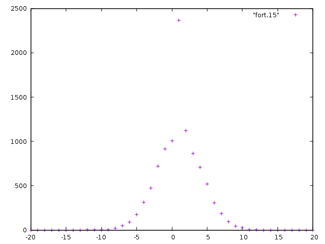

In the last post I had a problem about some arrays, I perfectly resolved it thanks to you, but now my problem is a little bit subtle. I have a subroutine(here I'll post it has a program )that generates random numbers in order to create errors so that those must have a Gaussian distribution and it is perfect, the program works perfectly, I can have a really nice Gaussian until I centred my points (that is what I must do to associated the errors to my data). After I centred the points I get a weird accumulation of point near x=1 that I can't explain.
Here is the program I'm talking about

The file that it reads is a column of data that I generate in my main program. I printed two files, one with the already centred points and one with the not centred ones. Now I would expect those two sets of points to give a Gaussian distribution but a you can see those are pretty different.
This pron(f)=2*0.1*(m(f)-0.5) is the line that I use to centre my points, it's something that we did in class with the teacher. I even thought that maybe it was the minus sign that was bothering fortran and I did some experiments like changing it with a plus and defining m(f) as negative. In the main program if I use the centred points I have a "lack" of precision, if I expect my output to be -3 I'll get -2.993... with an error of order 10-7 when with the not centred ones I get -3.001... with an error of order 10 -3.
I can't understand the problem if there is one or it is just me, maybe I'm missing something.
Thanks in advanced.

I am sorry for not being clear enough. In the program I posted, m(f) are random numbers with gaussian distribution. In reality I tried to obtain random numbers with a gaussian distribution centred at the origin in two ways, but I always run into the same problem. My first attempt was to compute random numbers with uniform distribution between -0.1 and 0.1 and then to use them in order to create random numbers k(f) with a gaussian distribution centred at the origin. To compute them I used the following code
Fortran:
do i=1,n
       call random_number(x(i))
end do
k(f)=sum(x)/n
where the values of x(i) are random numbers between 0 and 1. The problem is that I would like to have a gaussian distribution centred at 0 and not at 1/2, which should be the centre of the gaussian distribution generated above because it is the distribution of the mean values of random numbers with expectation value 1/2, if I'm not wrong. Moreover, even though the fortran function random_number(x) generates random numbers between 0 and 1, I would like to have them between -0.1 and 0.1. So I needed to multiply the random numbers generated by random_number(x) by 2*0.1, which is the maximum width, and after that I needed to subtract half of the maximum value, which is 0.1, so that my random numbers should be of the form randomnumber=2*0.1*(x-0.5) where x is generated with random_number(x). But in doing so I ran into the problem I described above, because if I only plotted my gaussian distribution obtained with the code above I had no problem, but if I plotted my k(f) calculated with the following code
Fortran:
do i=1,n
       randomnumber=2*0.1*(x(i)-0.5)
end do
k(f)=sum(randomnumber)/n
i found that weird crazy point. So I tried a second attempt, which is the one I quoted in my first post. This time I computed my k(f) with the first code, not including the line randomnumber=2*0.1*(x(i)-0.5), and then I tried to shift these numbers with gaussian distribution centered at 1/2 in order to obtain random numbers with a gaussian distribution centred at the origin. I thought that the same line could be used in order to shift the data because I still wanted a maximum width of 2*0.1 and still wanted the centre to be 0, but I am not sure of this. In the program above, the m(f) correspond to k(f). However I run again into exactly the same problem.
The second part of the program is used to make the gaussian distribution. I defined "l" to be the width of a single interval, that is I wrote l=0.1/h where h is the number of intervals I want between 0 and 0.1. After that I computed p=int(pron(i)/l). In this way I should be able to compute the integer part of pron(i)/l where pron(i) are my shifted random numbers of the second attempt. Doing so I know that the pth interval contains one of my random numbers, in this case pron(i) (rigorously speaking it should be the (p+1)th but I don't think it should change much), and to keep track of this I add 1 to the (p+n/2+1)th component of the array "a" that I defined to be a=0 before the do cycle. I added n/2+1 to the index of "a" so that, when p=0 I obtain that the random number is assigned to the (n/2+1)th component. Finally, to do the plot of the gaussian distributions, I defined an index ltot(j) to be ltot(j)=-(n/2.0)+j so that, when I plot the points (a(i), ltot(i)), I should obtain a gaussian distribution centered at the origin. That was what I thought, but obviously there is a problem somewhere. I hope to have been more clear!
Fortran:
do i=1,n
end do
k(f)=sum(x)/n
Your k(f) does not have a gaussian distribution. It has a Bates distribution, which is close to normal thanks to the central limit theorem and thanks to special properties of the uniform distribution. (It takes a lot more trials for the sum of independent exponentially distributed random variables converge toward a normal distribution than it does for the sum of independent uniformly distributed random variables.)
You can use this as an approximation of a guassian distribution, but you need to account for two things:
- The mean is not zero (it is 1/2)
- The variance is not one (it is 1/(12*n)).
You would have something close to [itex]N(0,1)[/itex] (the standard normal distribution, with mean 0 and variances 1) if you had used k(f)=sqrt(12.0d0*n)*(sum(x)/n-0.5). Converting from [itex]N(0,1)[/itex] to [itex]N(\mu,\sigma)[/itex] is fairly straightforward: Multiply by sigma and add mu.
