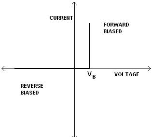

Forward biased ideal diode=>no voltage drop?
In summary, an "ideal" diode in forward bias refers to a diode that has zero voltage drop when conducting in one direction. This is often used in high voltage designs where the 0.7 volt drop across the diode is insignificant compared to the much higher voltages in the circuit. However, an ideal diode would have a vertical forward conducting line on the "Y" axis, not to the right of it as shown in graphs. It conducts perfectly in one direction and blocks perfectly in reverse.

Forward biased "ideal" diode=>no voltage drop?
Does a forward biased ideal diode have no voltage drop?
Yes, although it is difficult to say how zero volts can be called forward bias.
Of course, there is some voltage drop across a forward biased diode, but small. See the diode characteristics below.
When we speak abut an ideal diode, we either assume zero forward voltage or constant (0.7 V for Si diodes).
ehild
The "ideal diode" is a convenient fiction which is used when the actual voltage across the diode doesn't matter enough to be included in a calculation.
This is often the case in high voltage designs where the 0.7 volt drop across the diode is trivial compared with the much higher voltages in the circuit.
A voltage of zero volts can't have a polarity.
An ideal diode would have the vertical forward conducting line on the "Y" axis not to the right of it as these graphs show.
Ideal diode has zero volts with non-zero forward current. "Forward biased" refers to direction of conduction current. An ideal diode conducts perfectly in 1 direction (no forward voltage drop). It blocks perfectly in reverse (no leakage current).
Ideal diode has zero volts with non-zero amps in forward direction, vice-versa in reverse.
