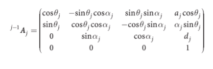

Derive the forward kinematics model in MATLAB using the DH parameters provided.
The homogeneous transformation matrix has the form shown in the attached image.
5 links (thus 6 frames) and corresponding theta, alpha, d and a values are all given.
However, I'm not sure how to start coding the DH parameters to derive a forward kinematics model.
I know that I'll have to use matrix operators, but do I just put in the values of the 4 factors mentioned above in the transformation matrix in the attached image and then calculate the transformation matrix from the origin to the end-effector?
Please help. Thanks.
Below is my code. I have all the DH parameters that will allow me to calculate the end effector position.
I'm not sure where to input the values of thetas 1 ~5 shown at the bottom. Please help.
function [T] = getTransformMatrix(theta, d, a, alpha)
T = [cosd(theta) -sind(theta) * cosd(alpha) sind(theta) * sind(alpha) a * cosd(theta);...
sind(theta) cosd(theta) * cosd(alpha) -cosd(theta) * sind(alpha) a * sind(theta);...
0,sind(alpha),cosd(alpha),d;...
0,0,0,1];
end
