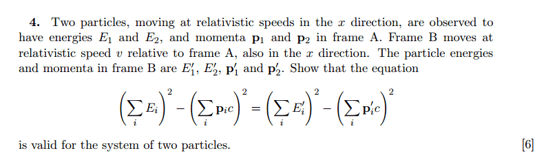

Four-momentum invariance between frames
In summary, the problem asks how to show that the terms 2E1E2 - 2(p1c)(p2c) are the same in both the non-primed and primed frames. By using the fact that (E,p) is a four-vector, it can be shown that these terms are indeed equal in both frames. The formula for Lorentz transformation between the (ct,x,y,z) and (ct',x',y',z') coordinates can be applied to any four-vector, and this can be used to define the four-momentum p as the four-vector with components (1,0,0,0) in the comoving inertial coordinate system. By choosing a curve x that is param
unscientific
1,734
E2 - p2c2 = E02
I know that this is true. But how do i relate p1 to p1'? and same for energy as well.
I expanded the LHS= E0,12 + E0,22 + 2E1E2 - 2(p1c)(p2c)
for the RHS =
E0,12 + E0,22 + 2E'1E'2 - 2(p'1c)(p'2c)
Obviously the rest mass energies equate on both LHS and RHS but how do i show that the 2E1E2 - 2(p1c)(p2c) terms are the same?
If you're allowed to use that ##(E,\mathbf p)## is a 4-vector, the problem is pretty easy. (You know that the "square" of a 4-vector is invariant, right?)
Do you think you're allowed to use that, or are you supposed to use something else entirely?

By applying Lorenz transformation from one system to another you may be able to check whether (1)=(2) .
You know
$$ E_1E_2-cp_1cp_2=
E_{0,1}E_{0,2} g_{\mu\nu} U^\mu_1 U^\nu_2=g_{\mu\nu} p^\mu_1 p^\nu_2 $$
,where U is four-voloecity, is scalar product of two four vectors which is invariant under change of frame. Please be suggested to check invariance through Lorenz transformation of velocities.
Hint: The scalar product of two four-vectors is invariant.

You know the formula of Lorentz transformation between (ct,x,y,z) and (ct',x',y',z').
Replace ct with E/c and x with p_x in the formula. This is what you want.

You can apply the Lorentz transformation to any four-vector. That's actually one possible way to define the term "four-vector". If we use this definition, then a good way to define the four-momentum p is to say that it's the four-vector with components (1,0,0,0) in the comoving inertial coordinate system. (I'm using the convention to put the time coordinate first, and units such that c=1).
But I think this explanation may be more enlightening: The world line of a particle is the graph of a curve ##x:\mathbb R\to\mathbb R^4##. Now, there are many such functions that have the same graph, so we can make a clever choice of the curve x. We choose x such that for all ##t\in\mathbb R##, t is the proper time of the curve segment from x(0) to x(t). Such a curve is said to be parametrized by proper time.
I'm not going to do it here, but it's possible to show that this implies that ##x'(t)^T\eta x'(t)=-1##. This is going to be very useful in a minute.
The four-velocity is defined as the normalized tangent vector of the curve x. For all ##t\in\mathbb R##, the derivative x'(t) is a tangent vector of the curve at x(t). If we denote the four-velocity by u, we have
$$u(t)=\frac{x'(t)}{\sqrt{-x'(t)^T\eta x'(t)}}=x'(t).$$ This is why we chose x to be parametrized by proper time.
The four-momentum p is defined by ##p=mu##. So we have
$$p=mu=mx'=m\frac{d}{dt}x.$$ Now we can see what happens to p if we do a Lorentz transformation of x. As x changes to ##\Lambda x##, p changes to
$$m\frac{d}{dt}\left(\Lambda x\right).$$ If we denote this by p', we have
$$p'=m\frac{d}{dt}\left(\Lambda x\right) =\Lambda\left(m\frac{d}{dt} x\right)=\Lambda p.$$
I really think that the only thing you're supposed to do in this problem is to show that if the 0 component (or 4 component, depending on your book's convention) of the four-momentum p is denoted by E, then that equality holds. You are supposed to know somehow that four-momentum is a four-vector and that the 0 (or 4) component is energy. How exactly you're supposed to know that I don't know. It's probably in your book.
The problem is very easy if you have some familiarity with four-vectors. You should begin by proving that the "square" of every four-vector is invariant. The "square" is defined using the metric g,
$$p^2=g(p,p)=p^T\eta p.$$ This is how I would write it anyway. I don't know anything about the notational conventions used by the book you're reading.

You really almost had it proven in your original posting when you concluded that you had to prove that
[tex]E_1E_2-(p_1c)(p_2c)=E'_1E'_2-(p'_1c)(p'_2c)[/tex]
Actually, this equation should more properly have been written as
[tex]E_1E_2-(\vec{p_1c})\centerdot \vec{(p_2c)}=E'_1E'_2-(\vec{p'_1c})\centerdot \vec{(p'_2c)}[/tex]
where [itex](\vec{p_1c})\centerdot \vec{(p_2c)}[/itex] is the dot product of the spatial (3D) vector [itex](\vec{p_1c})[/itex] with the spatial (3D) vector [itex](\vec{p_2c})[/itex], as reckoned from the unprimed frame of reference, and with a similar interpretation for the analogous vectors as reckoned from the primed frame of reference.
The left-hand side of the equation can be recognized as the scalar product of the 4 momentum of particle 1 with the 4 momentum of particle 2 (for +--- sign signature) as reckoned from the unprimed frame of reference, and the right-hand side of the equation can be recognized as the scalar product of the 4 momentum of particle 1 with the 4 momentum of particle 2 as reckoned from the primed frame of reference. But, the scalar product of any two 4 vectors is frame invariant. Therefore, QED.

unscientific, I hope you understand that we can't tell you anything more if you don't make an effort of your own. You need to study the most basic stuff about four-vectors in your book. In particular, make sure that you understand the "scalar product" of four-vectors. (It's not actually an inner product, so it may be called something else in your book. What I'm talking about is a function that takes two four-vectors to a number, that's defined in all relativity texts).
If you don't think you're allowed to use stuff about four-vectors (I think you are, and that this makes this problem trivial), then you need to study your book to see what you are allowed to use. If you want help here, you must tell us what you find.
The problem is really easy if you write everything in terms of rapidities. The rapidity ##\theta## that corresponds to velocity ##v## is given by ##\theta = \tanh^{-1} (v/c)##, where ##c## is the speed of light. You should be able to show for a particle of mass ##m## moving with velocity ##v## that

Unless I'm making some silly blunder, it's much easier than that. No need to involve rapidity. No need to express E,p or v in terms of something else. Just use the most basic facts about four-vectors.
Unscientific seems to be reluctant to do that. I figured he or she is already familiar with the expressions for E, p, and the velocity-addition formula.
